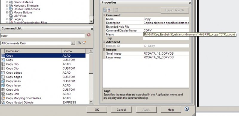

rboudreaux Posted February 18, 2015 Posted February 18, 2015 Hey, guys, I am using Autocad 2013. Presently, my COPY command will copy only once. I want to change it to where it will hold the copy and make multiple copies of the same selection. Is this making any sense? Thanks, Rich Quote

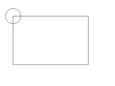

nestly Posted February 18, 2015 Posted February 18, 2015 So you're looking for COPY to do something other than what's shown below? Quote
rboudreaux Posted February 18, 2015 Author Posted February 18, 2015 That is exactly what I am looking for, but presently, I can only make one copy of an object then I must go back to my COPY icon to make any more copies of that same object. Quote
nestly Posted February 18, 2015 Posted February 18, 2015 Here is the macro from "vanilla" AutoCAD, if you want to compare it to your macro, but be aware that mOde within the command is still what determines whether it's single or multiple mode. $M=$(if,$(eq,$(substr,$(getvar,cmdnames),1,4),GRIP),_copy,^C^C_copy) Quote

RobDraw Posted February 20, 2015 Posted February 20, 2015 Nestly showed you what the macro is, did you compare and fix if necessary? Quote
rboudreaux Posted February 20, 2015 Author Posted February 20, 2015 Robdraw, It is working OK now. Thanks, Rich Quote
