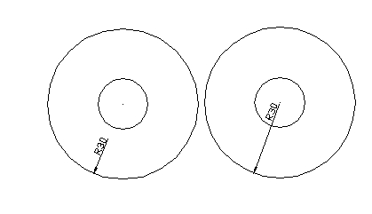

Well I have a problem with dimension text aligning.
I need that text of dimensions must be in the middle of the arrow.
If I try to put a mouse with text in the middle, the the arrow is half shorter than normal. (picture in LEFT)
If I try to make a long arrow, then its text is in the end. (picture in RIGHT)
What could you advise?

Go to your dimension style, click modify, click on the fit tab, select 'both text and arrows' on the left hand side and select 'place text manually' on the right hand side. Then place your radial dimension.

Thank you! :) You're genius.
