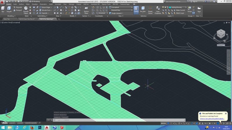

Hello
This may be a silly question .....
But what are these random lines on the surface of my shapes - and how do I get rid of them ?150214 CAD Error.jpg
Are you speaking in reference to the barely visible (in the image anyways) pale white lines?
I do yes - although they are much more evident on screen
Maybe convert 3d entities to regions with REGION command and after perform UNION on them...
Regards, M.R.
They look like they could be 3DFACE edges. Convert the faces to regions then combine with union.
