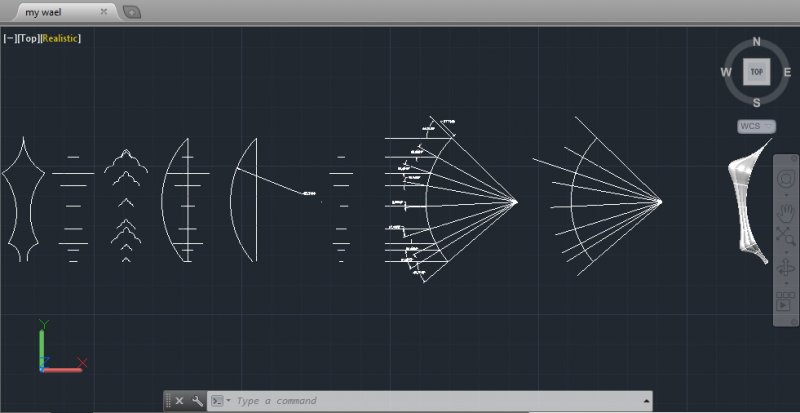

There is really a way to do it, but it is time- and ressource-consuming (for my computer ;-)).
1. Create the cylinder and an arc on its surface - having the same length as the object to bend.
2. Slice the object into slices to get a "good fitted model ".
3. Create cross-section from the slices pieces.
4. Locate them on the arc using 3DALIGN.
5. Use LOFT using the located cross-sections and the arc as guide line.
This are only the main steps. You have to transform Splines into Polys on the way and some more trouble...
Good luck
Jochen
Dear Jochen
I have summarized all steps which previously did,i think it is the same steps ,but because i'm still AUTOCAD beginner and this the first CAD work ,i think that i make more and more steps more than you did ,really you have good experience and professional technique and i learned some of autocad command from your post , which spends less time work if i know it,any way,i have noted that lofted pattern must be Perpendicular to fit the arc radius ,
finally thank you very much for all ,and hope other friend have and feedback us with different technique.
(sorry for my Poor english skills)
Regards
Wael elsafty
