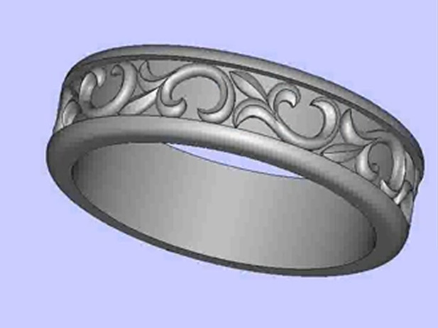

Cad64 Posted February 14, 2015 Posted February 14, 2015 ReMark said: Make it an image and attach it as a material. That might work . . . IF . . . Autocad had displacement mapping. But even still, it would be difficult to create a displacement map that would extrude the geometry out from the ring as shown in the image below. By the way, if this image would have been provided in the first post it would have saved everyone a lot of time posting advice that was not relevant to the question. For doing this type of work I would wholeheartedly recommend using ZBrush. Take a look at this video: Quote
wael elsafty Posted February 14, 2015 Author Posted February 14, 2015 YES YES YES IT IS WHAT I WANT MR. GP_ and hope more method to do this project thank you Quote
wael elsafty Posted February 14, 2015 Author Posted February 14, 2015 Cad64 said: That might work . . . IF . . . Autocad had displacement mapping. But even still, it would be difficult to create a displacement map that would extrude the geometry out from the ring as shown in the image below. By the way, if this image would have been provided in the first post it would have saved everyone a lot of time posting advice that was not relevant to the question. For doing this type of work I would wholeheartedly recommend using ZBrush. Take a look at this video: yes there are many soft ware can be crate this ring easy but i need to do that using autocad ,thanks for help mr.Cad64 Quote

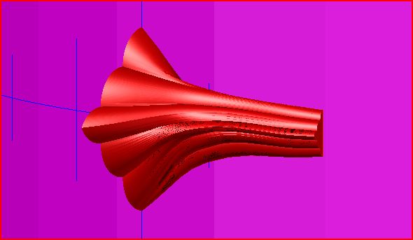

wael elsafty Posted February 15, 2015 Author Posted February 15, 2015 scj said: Suppose (and hope), the attachement will meet your wishes.I'm doint the IMPRINT-Project for http://www.ant-ares.de and it is not finished yet. In case of interest contact me. Regards Jochen Mr.scj you are genuis .yes the file you attched is meet my requirment ,it is exactly my needed please tell me how you do that in detailed steps thank you Quote
wael elsafty Posted February 21, 2015 Author Posted February 21, 2015 hello , the next step i need to do is how to loft the curved 3d surface after imprent it and explod it please help i need to loft it now thanks Quote
scj Posted February 23, 2015 Posted February 23, 2015 You can upload your model - or send it to me (via http://www.black-cad.de) Regards Jochen Quote

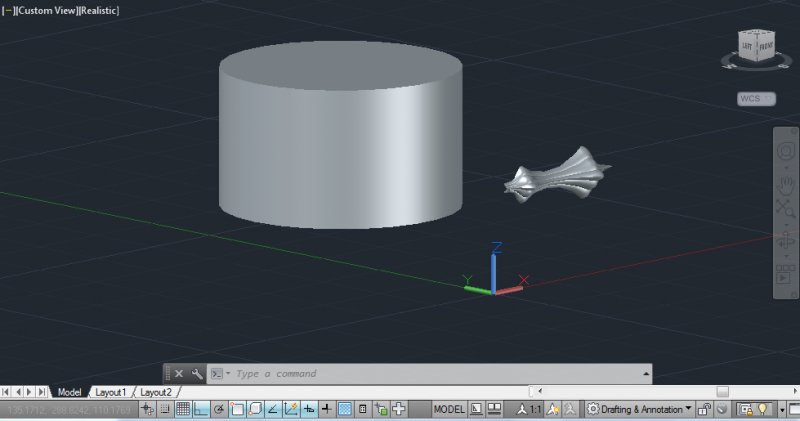

wael elsafty Posted February 23, 2015 Author Posted February 23, 2015 Hello my Fiends I need to Wrapping LOFTED pattern OVER a cylinder in autocad 2014 please check the attached photo for this case. I need any technique to do this step ,so please help me . Thanks in advance Quote
SEANT Posted February 24, 2015 Posted February 24, 2015 AutoCAD does not include functionality that morphs 3D objects in the manner you describe. The best you could do it to model the applique based on cross sections and guide rails that conform to the cylinder. Quote
wael elsafty Posted February 24, 2015 Author Posted February 24, 2015 Thank you Sir , may you give me more explanations,especially in the guide rail step,how i can do in the easiest way. thanks Quote
SEANT Posted February 24, 2015 Posted February 24, 2015 You made the loft using guide curves that were flat. They need a curve that bend at the desired radius. The cross sections also need to be rotated to stay perpendicular to the cylinders surface. Without a doubt this is complex stuff. Quite frankly, AutoCAD is not the best tool for the job. You would be much better off using a surface modeler, such as the rhino program you have already alluded to. Download the trial version and use their advanced deformation tools. The geometry can then be re-imported into AutoCAD if needed. Quote

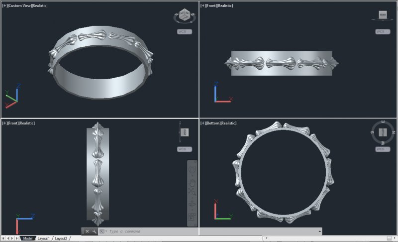

wael elsafty Posted February 25, 2015 Author Posted February 25, 2015 (edited) THIS IS MY FIRST AND SAMPLE WORK i have done my require just now,please review and feedback me if any technical issue.AND MANY THANKS FOR ANYONE HELP AND SUPPORT ME BEST REGARDS FOR ALL WAEL ELSAFTY Edited February 25, 2015 by wael elsafty Quote
ReMark Posted February 25, 2015 Posted February 25, 2015 What you currently have are straight objects arrayed around a circular object. Wouldn't you want the lofted object to be slightly curved as well? Quote

wael elsafty Posted February 25, 2015 Author Posted February 25, 2015 im sorry for duplicate posts ,but i tried to do the case ans i posted it to now if any error ,so please feedbaack and suggested other solutions,i hvae curved the pattern first and arrayed it ,hope get new method or ways to act. thanks for all Quote
ReMark Posted February 25, 2015 Posted February 25, 2015 Shouldn't these objects be curved the same as the main ring? They look straight to me like a dog bone or a dumbbell that's been stuck to the circumference of the ring. Quote
scj Posted February 25, 2015 Posted February 25, 2015 There is really a way to do it, but it is time- and ressource-consuming (for my computer ;-)). 1. Create the cylinder and an arc on its surface - having the same length as the object to bend. 2. Slice the object into slices to get a "good fitted model ". 3. Create cross-section from the slices pieces. 4. Locate them on the arc using 3DALIGN. 5. Use LOFT using the located cross-sections and the arc as guide line. This are only the main steps. You have to transform Splines into Polys on the way and some more trouble... Good luck Jochen wael_4.dwgFetching info... Quote
