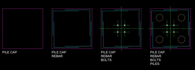

ReMark Posted February 13, 2015 Posted February 13, 2015 pisces: Once your computer is squared away (AutoCAD repaired or you install DraftSight) this is how you might go about approaching the plan view of the pile cap. Note that this is not the finished version of the view but it should be enough to get you started. It would be to your advantage to draw some of the objects just once then use the Mirror command to create the remaining objects (ex. - bolts). You can see that I have created separate layers for the pile cap, rebar, bolts, piles and centerlines. This makes it easier to distinguish between objects when drawings start to become more complex but it is a good habit to develop early on. Quote

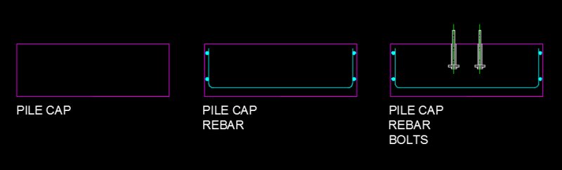

ReMark Posted February 13, 2015 Posted February 13, 2015 This is how you might go about starting the sectional view. As for the bolt detail I'd just "borrow" the bolts from the plan view. No need to redraw them. Will you be doing all this in model space or has your instructor covered the use of paper space layouts and viewports? Quote
