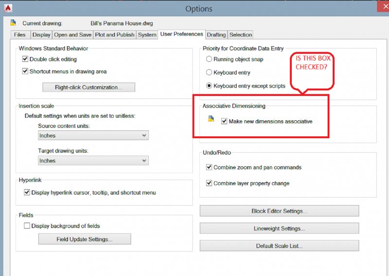

Dana W Posted February 7, 2015 Posted February 7, 2015 There is a clear direction of investigation already pointed out to at least make the occurrence less frequent. Part 1: Quote
Dana W Posted February 7, 2015 Posted February 7, 2015 Part 2: If you are not using associative dimensions, the rest of this doesn't apply, and it is up to your hand and eyeballs. Paperspace dimensions and modelspace objects Do Not work well unless the dimensions are associative. Do you use osnap to set your dimensions? If so, do you have NODE selected as one of the snaps? If you do, then turn NODE off while setting dimensions. It will cause the dimensions to be associated to each other rather than your drawing geometry, which renders the associative function useless. More to come, waffles are ready. Quote

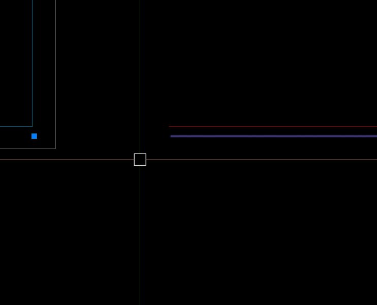

Dana W Posted February 7, 2015 Posted February 7, 2015 Part 3: When you zoom way in on your dimension grips, do you see this? Even associative dimensions don't help without the node being right on the geometry. If your precision level is set larger than the gap between the dimension node and your geometry, the dimension will still show the correct dimension, until in the case of paperspace dimensions they are manipulated in some way. Quote
