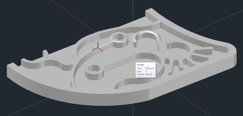

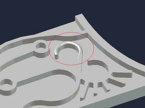

I'm trying to fillet all of the edges of the winding extrusions on this part. I've circled one section that partially filleted, with the exception of the narrow curve. When I try to do other areas this error comes up:
Modeling Operation Error:
Could not find acceptable sequence of capping faces to trim blend face.
Failed to perform blend.
Failure while filleting.
Any thoughts? I'm running the student version of AutoCAD 2015
3d Pauldron 2.dwg
I just spent about 15 minutes trying to do it, and while it looked like it was going to work,
I too got blend failure problems repeatedly.
You might try reducing the radius of your fillet.
Do you still have the original linework from which you created the 3D Solid?
If you do, try posting that, as it may help to shed some light on the problem.
I didn't have any trouble after removing the existing Fillets then re-filleting a 1.5 radius using the Chain option
Thanks for the replies. The method shown in the gif fixed the circled area, but there are still a few other areas that it doesn't work. To clarify, I'd like to fillet all of the raised details in the manner shown in the gif.
I've attached the 2D drawing that I based the model off of and circled one of the problem areas. Like I said, some of the details will fillet, other areas won't.
Line Base.dwg
I believe there are some inconsistencies and discontinuities (non-tangent) issues that may be causing the problem. I also had trouble with that area in your 3D model, but after cleaning up the overlaps and refilleting all the 1.43218200R fillets, I was able to extrude your 2D geometry and fillet all the edges without trouble using the Chain option to make sure all the edges on the perimeter were selected.
