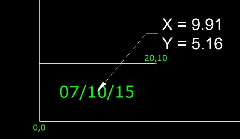

Is it possible to change this to centre the text/mtext between two selected points?
Sometimes it's desirable to centre the *text to part of a block or a non rectangular polygon or even simply between two entities.
I did try to work out where the second part of the move command was, but I'm baffled

That's peculiar, I'm sure that it worked great yesterday. After using the modified lisp a few times I notice a slight error.
Please Lee, if you ever find a spare few minutes....
Are you reading the coordinates of the text alignment point or the center of the bounding box of the text object?
Note that the program is positioning the text based on the center of the bounding box, not the text alignment point.
The leader is on the alignment point..
I was just thinking that the lisp calculates the centre of the text from the overall size of the text entity, in which of course the insertion point may not be the same as the centre of the text depending what characters are within the string.
Lee...
