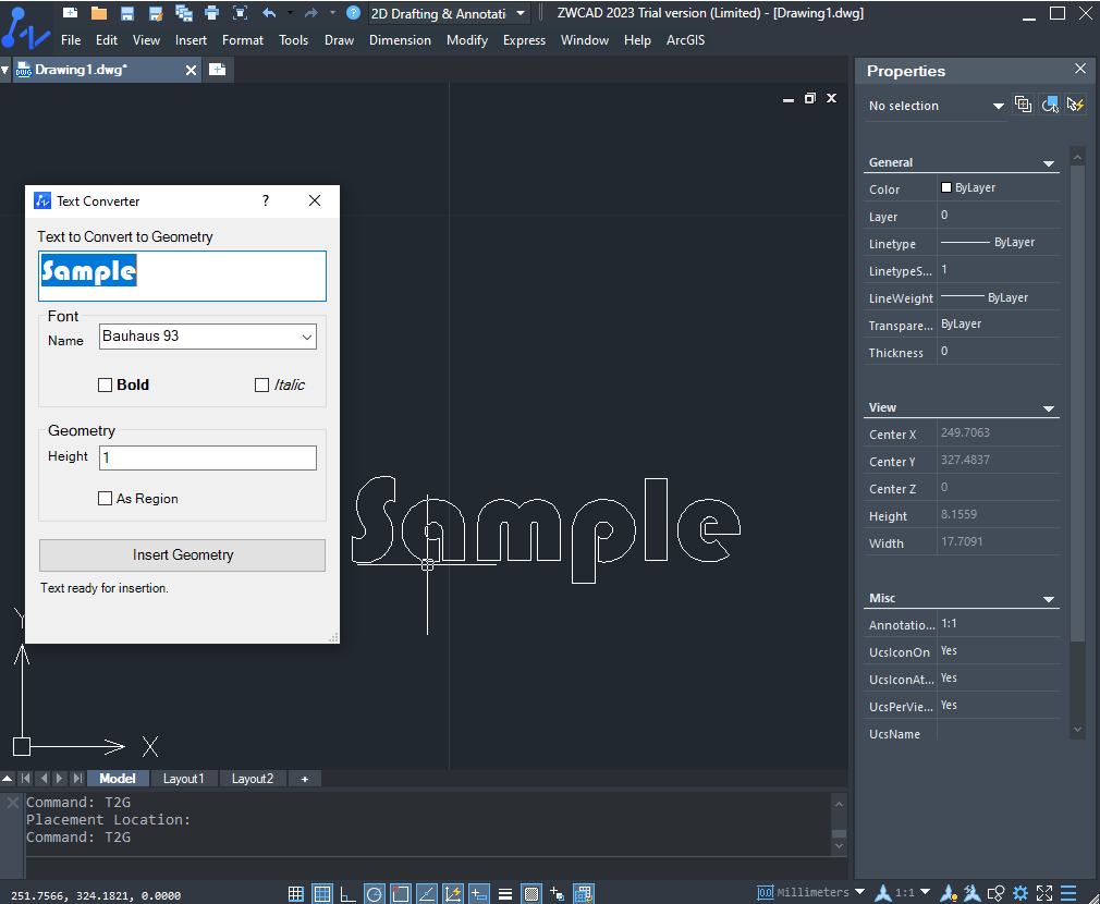

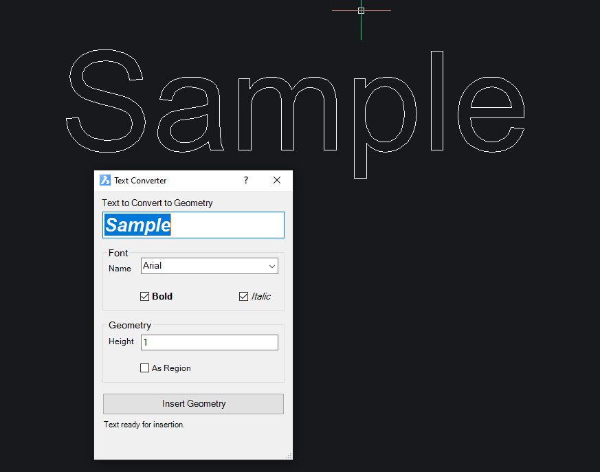

Danielm103 Posted October 28, 2022 Posted October 28, 2022 (edited) Here's a solution with projects for AutoCAD2023 and BricsCADv22, and binaries. I tried to make a version for ZwCad, but AcAp.Application.UserConfigurationManager.OpenCurrentProfile(); failed. warning CS0618: 'GlyphRun... has been depreciated Edited October 31, 2022 by Danielm103 1 Quote

Danielm103 Posted October 31, 2022 Posted October 31, 2022 ZwCad responded back on my support request, here’s an updated solution and binaries for AutoCAD, BricsCAD and ZwCad. Super cool app! STSC_TextToGeometry_v19.zipFetching info... Quote
