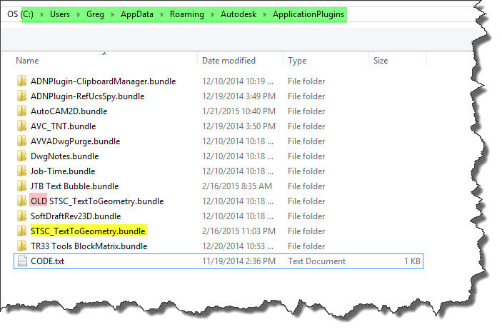

troggarf Posted February 17, 2015 Posted February 17, 2015 I love testing ad-ons for people Note: I did make sure to right click and "Unblock" the .dll files Here is the error I am getting after net loading your .dll on AutoCAD 2015 Command: NETLOAD Cannot load assembly. Error details: System.IO.FileLoadException: Could not load file or assembly 'file:///C:\Users\Greg\AppData\Roaming\Autodesk\ApplicationPlugins\STSC_TextToGeometry.bundle\Contents\Support\STSC_Text2Geom_v19.dll' or one of its dependencies. Operation is not supported. (Exception from HRESULT: 0x80131515) File name: 'file:///C:\Users\Greg\AppData\Roaming\Autodesk\ApplicationPlugins\STSC_TextToGeometry.bundle\Contents\Support\STSC_Text2Geom_v19.dll' ---> System.NotSupportedException: An attempt was made to load an assembly from a network location which would have caused the assembly to be sandboxed in previous versions of the .NET Framework. This release of the .NET Framework does not enable CAS policy by default, so this load may be dangerous. If this load is not intended to sandbox the assembly, please enable the loadFromRemoteSources switch. See http://go.microsoft.com/fwlink/?LinkId=155569 for more information. at System.Reflection.RuntimeAssembly._nLoad(AssemblyName fileName, String codeBase, Evidence assemblySecurity, RuntimeAssembly locationHint, StackCrawlMark& stackMark, IntPtr pPrivHostBinder, Boolean throwOnFileNotFound, Boolean forIntrospection, Boolean suppressSecurityChecks) at System.Reflection.RuntimeAssembly.InternalLoadAssemblyName(AssemblyName assemblyRef, Evidence assemblySecurity, RuntimeAssembly reqAssembly, StackCrawlMark& stackMark, IntPtr pPrivHostBinder, Boolean throwOnFileNotFound, Boolean forIntrospection, Boolean suppressSecurityChecks) at System.Reflection.RuntimeAssembly.InternalLoadAssemblyName(AssemblyName assemblyRef, Evidence assemblySecurity, RuntimeAssembly reqAssembly, StackCrawlMark& stackMark, Boolean throwOnFileNotFound, Boolean forIntrospection, Boolean suppressSecurityChecks) at System.Reflection.RuntimeAssembly.InternalLoadFrom(String assemblyFile, Evidence securityEvidence, Byte[] hashValue, AssemblyHashAlgorithm hashAlgorithm, Boolean forIntrospection, Boolean suppressSecurityChecks, StackCrawlMark& stackMark) at System.Reflection.Assembly.LoadFrom(String assemblyFile) at Autodesk.AutoCAD.Runtime.ExtensionLoader.Load(String fileName) at loadmgd() Quote
BlackBox Posted February 17, 2015 Posted February 17, 2015 Hey Greg, Where on your network are you attempting to load the assembly from? More on enabling LoadFromRemoteSources in Acad.exe.config file here, which I haven't personally needed since 2011, or 2012: http://through-the-interface.typepad.com/through_the_interface/2011/07/loading-blocked-and-network-hosted-assemblies-with-net-4.html Cheers Quote
SEANT Posted February 17, 2015 Author Posted February 17, 2015 Hi Greg, thanks for testing this for me. Ideally, with the use of the .Bundle format, a user would not have to Netload anything. Autodesk has set up the process such that any bundle found in a couple of specific locations (one being C:\Users\UserName\AppData\Roaming\Autodesk\ApplicationPlugins) would have the pertinent DLLs loaded automatically (either at startup or upon command invocation). What happens if you type T2G, without using the netload command? Quote
GP_ Posted February 17, 2015 Posted February 17, 2015 SEANT said: This is a 2015 upgrade to an existing app... Thank you Seant, works fine. Quote
SEANT Posted February 17, 2015 Author Posted February 17, 2015 Good to hear, GP_. I did not get to it in a timely manner, but thanks for the promo here: http://www.cadtutor.net/forum/showthread.php?90936-How-to-curve-an-3d-object-around-arc-in-autocad&p=622640&viewfull=1#post622640 Incidentally, I'll be beta testing a 2015 update for that UV Vector Mapping routine shortly. Quote
troggarf Posted February 17, 2015 Posted February 17, 2015 Sean, It is working now. The reason I was using net load was because I usually see a pop up saying that such-n-such plug-in has loaded and I didn't it when I copied your .bundle into its Application plugins folder. However, your ribbon panel did show up in the Add-ins ribbon. So I clicked on the icon and then got the error saying "Unknown command: _t2g"... So that is why I went ahead and used netload. I think that I simply needed to restart AutoCAD again for it to fully kick in. All is good now. But now you have to make one work for 2016 before it gets released. HAHA Thanks again, ~Greg Quote
