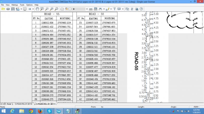

l-student-l Posted January 29, 2015 Posted January 29, 2015 Hi Everybody, I need some Help ?? May anybody tell me how can i make coordinates tables like as i attached pic?? Waiting for experts good Responce.. Thank You . Sorry for my Bad English Quote
ReMark Posted January 29, 2015 Posted January 29, 2015 So you have a drawing that has a number of points and you want to extract the easting and northing coordinates of each point and display in a table in the same drawing. Is that what you are asking for help with? Quote
azwaah Posted January 29, 2015 Posted January 29, 2015 No Sir , i Have only Drawing as attached?? i want to know how to insert points and make table. . . Waiting for ur good Responce. . . . . Thank You. Quote
azwaah Posted January 29, 2015 Posted January 29, 2015 And Yes I want Easting and Northing table in Same Drawing . . Quote

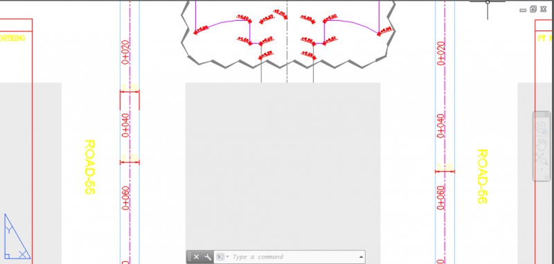

azwaah Posted January 30, 2015 Posted January 30, 2015 Hi Sir This is sample drawing . . hope you people will help me to solve my problum. .Thank You. https://www.dropbox.com/s/u5r39kes472w6zv/sample.dwg?dl=0 Quote
