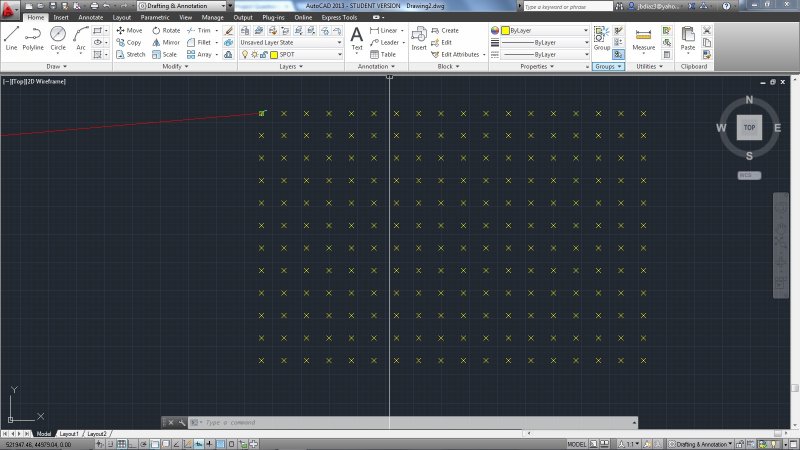

see #4 it says rows twice not rows then columns.
this is the screen shot.
and AutoCad propts are different then what PF are saying in this project.
You are right. It is rows and columns.
What AutoCAD prompts (different) are you talking about?
this is how i did it Remark.
Command: _arrayrect
Select objects: 1 found
Select objects: 1 found, 2 total
Select objects:
Type = Rectangular Associative = Yes
Select grip to edit array or [ASsociative/Base point/COUnt/Spacing/COLumns/Rows/Levels/eXit]: R
Enter the number of rows or [Expression] : 12
Specify the distance between rows or [Total/Expression] : -50
Specify the incrementing elevation between rows or [Expresson] :
Select grip to edit array or [ASsociative/Base point/COUnt/Spacing/COLumns/Rows/Levels/eXit]: COL
Enter the number of columns or [Expression] : 18
Specify the distance between columns or [Total/Expression] : 50
you can pick what to do next.
The different prompts you are seeing as compared to what Penn-Foster says is probably due to the fact that the instructions have not been updated to reflect changes in the ARRAY command. P-F is using the old command which is still available if one knows how to access it via the command line.

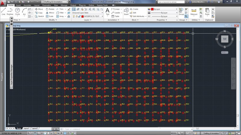

This has taken me ALL weekend to all the marks at 10's. crazy. Next I have a question in the nest post.
