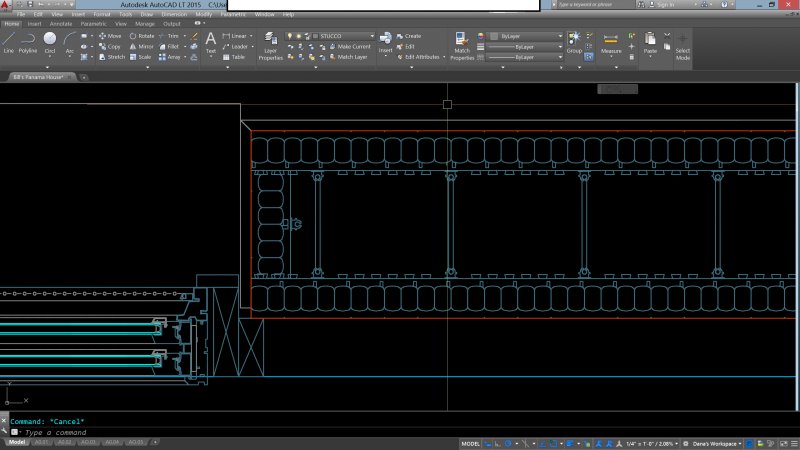

Dana W Posted January 30, 2015 Posted January 30, 2015 I like the level of detail Dana. Nice job.Appreciate it, but actually the drafters at Andersen and Nudura drew those. I just used my layers instead of theirs and changed their blocks to my blocks. If I could get those cells in the 2 1/4" insulation panels to array properly, I'd dynamically alter the ICF forms blocks. I still have to deal with Metwood and Quad-Deck floor systems, and Red Steel roof framing, and plastic replica Spanish terracotta roof tiles. Quote

MDrawings Posted January 30, 2015 Posted January 30, 2015 (edited) ... If I could get those cells in the 2 1/4" insulation panels to array properly, I'd dynamically alter the ICF forms blocks. . Is the attached what you're looking for? For function I mean. BLOCK ARRAY.dwg Edited January 30, 2015 by MDrawings spelling Quote

Dana W Posted January 31, 2015 Posted January 31, 2015 Is the attached what you're looking for?For function I mean. Well yeah, that's the basis for it. I am just at the point today where I recognized the need for the dyn array block. I don't have issues with the array part, just getting my head around trying it. I have to get all that hoodoo inside that concrete form plan view I posted to array on the pattern repeat, whatever that is. I've already included the end cap of the form units in my window and door jambs since a jamb without one doesn't exist in the house, so I'm thinking 20 minutes to get it working. Unfortunately, it will need to finish on a random length partial pattern, so I will probably use two blocks. I'll see what happens tomorrow. Quote

Dana W Posted January 31, 2015 Posted January 31, 2015 Is the attached what you're looking for?For function I mean. Here it is. Simple. The hardest part was finding the pattern break. Seven minutes instead of twenty. Saved in 2010. DYN 6 INCH ICF PLAN.dwg Quote
