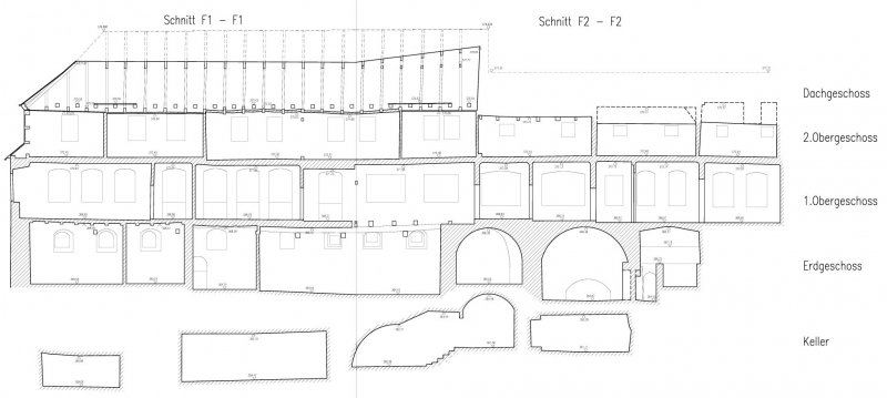

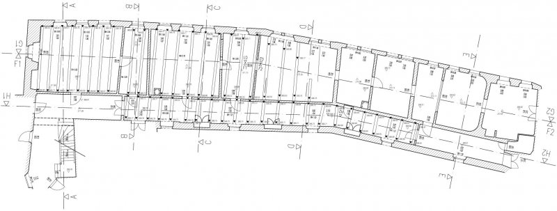

A couple of larger images for f700es
They had removed the old floorboards around the edges of the room so that we could survey the floor joist and get a precise level on each one.
In the section you can see how the ceilings sag and how their thickness's vary. No way you can get that amount of detail with a tape or Disto, well not in a realistic time. We needed 15 minutes per room from walking in to walking out finished. Drawing it all up takes a little longer than normal, but look at the amount of detail there is to draw up.
What was a pity was that the architects only wanted 2D AutoCAD drawings, because they can't handle 3D! The 3D scan data is all still there if it ever will be needed. By the way that job takes up over 400 GB on the server!
