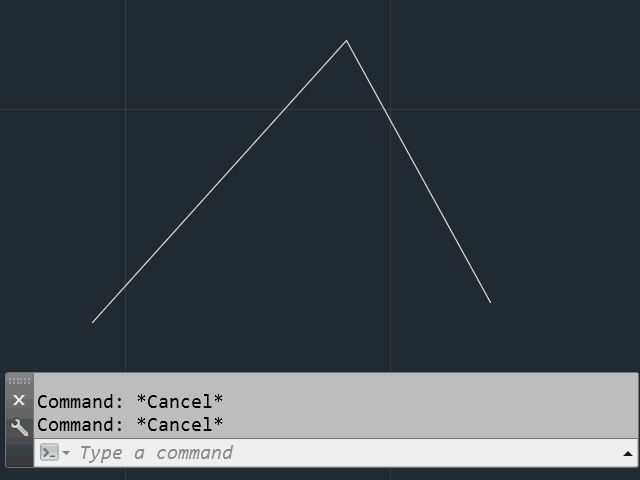

OK, I just wanted to make sure you knew there's a difference between JOIN and .JOIN. Animation below made using AutoCAD MEP2015
