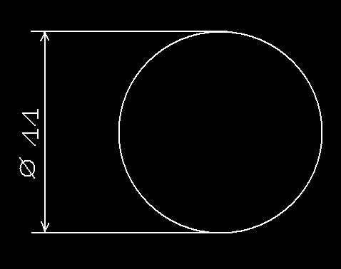

Hello, I'm new at AutoCad and need some help.
I need to get the diameter dimensions, but it must be linear with 2 arrows, not 1. Like in picture.
Problem: I don't know how to write a diameter symbol before the number.

There is a differnce between doing a diameter dimension and a linear dimension representing a diameter. You are doing the latter.
To get the diameter symbol - click on the dimension, type properties and in the pallette that comes up scroll down to text. In the text overrride box you need to type
%%c11
You can look up special characters in help to get more info
%%C will give you the diameter symbol if you need to put it in a linear dimension, just add that into the Dim prefix field under the Primary Units heading of your Properties palette. I too would recommend you use the DIMDIAMETER command though.
Oh, thank you! You're Great!
