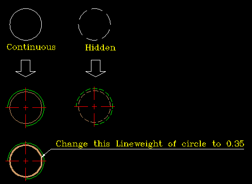

If I select the circle linetype is "Continuous", SO change the circle Lineweight to 0.35

Maybe ... try it.
(mapcar '(lambda (x)
          (vlax-put (car x) 'layer "screw")
          (vlax-put (car x) 'color (cadr x))
          (vlax-put (car x) "linetype" (caddr x))
          (vlax-put (car x) "linetypescale" xk)
          (if (and (eq (vla-get-objectname (car x)) "AcDbCircle")
                   (eq (vla-get-linetype (car x)) "Continuous")
            (vla-put-lineweight (car x) acLnWt035)

Maybe ... try it.
Mr.Tharwat. You are too professional.
very well.

But ,I don't know ,how change layer of the line for this lisp:
            (vla-put-lineweight cir acLnWt035)
           (list (list cir 33 cel)
                 (list arc 3 cel)
[color="#ff00ff"]                  (list ln1 1 "center")
                 (list ln2 1 "center")[/color]
and how change the layer of text ?
