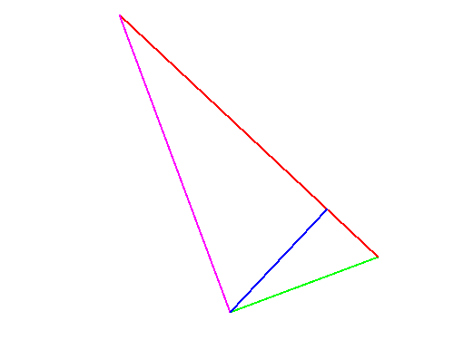

First, I draw an oblique red line.
Next, I draw a blue line that is perpendicular to the red line
intersecting at point 1 and end at point 2.
How do I draw the magenta line (B line) that starts from point 3 and end at point 2, which is perpendicular to the green line (C line) that starts from point 4 and end at point 2.

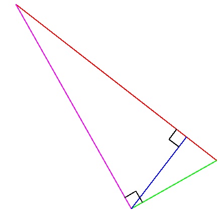

Brush up on pythgaros theorem it should be solvable and a/sina=b/sinb=c/sinc a triangle has 180 degrees, angle of red line is known, angle of blue line is known.
OK, so what are the known values? If the red line is the constant, you either need the distance from one end of the red line to point "1", or you need to know the length of the blue line. The animation below can be created by drawing any right triangle then a line perpendicular to the hypotenuse. then use Geometric Constraints > AutoConstrain. Add a dimensional constraint for the length of the red line plus one more for either distance 4-1 or distance
2-1 and it solves itself.

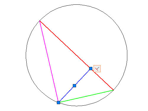

Draw a circle centered on the mid point of A and diameter A. The intersection of this circle and the blue line gives the third vertex of the triangle.

Yes, the circle method is more elegant.
