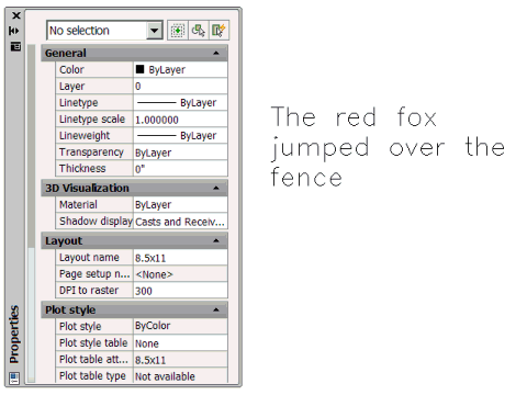

The Justify tools inside the text editor change the justification of selected text relative to the width of the mtext object. I believe "Middle Center" is only available as a justification for the insertion point of the entire mtext object. (I use the Properties Palette)
Click on the "A" button under the textstyle name. That list is the full range of justification options, regardless of the insertion point. These options justify the entire contents of the text box without having to highlight any particular part of the text itself. It is another way of accessing the options in the Justify row of the properties pallet.
A good rule of thumb is that if you are justifying the entire text object is to use the properties pallet. If you are justifying only a part of the text, use the toolbar.
