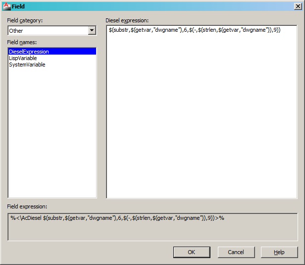

I got it, the idea, but I can't found the location to write the specific function to put it in a Field of attribute. Can you write it? What type of attribute could be used to do it?...
Thanks again!...
Right Click in the Attribute Editor Value box and select Insert Field.
Field Category = Other > Field Names = Diesel Expression > Diesel Expression goes in area to the right labeled Diesel Expression.
Thank you a lot SLW210 and dbroada, to your answers!... It works as good as I need!!!...
Hi SLW210, Using this Diesel expession I have made a small alteration that works as good the first:
$(substr,$(getvar,"dwgname"),42,2)
**"xx" it's the length where the text will be cutted, and the number two (2) is how many letters do you need.
Thank you!...
