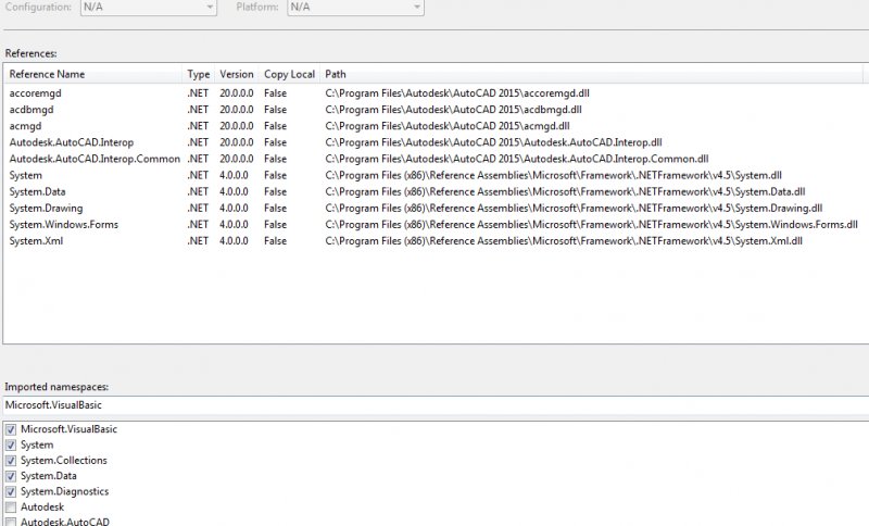

I've created a dll, with a few commands, in Visual Studio. It all works great on my PC, but when I Netload it on another PC, it doesn't recognize my commands.
It does not give error messages at any time. It just doesn't work (as if I didn't load it).

Hello BlackBox,
Thank you so much for the reply.
I am using Civil 3d 2015. The other PC has Civil 3D 2014.
Both are x64 Windows 7
I'm targeting .NET Framework 4.5
I'm NETLOADing from the local disk.
I've stepped through code at debugging, and everything seems fine.
I'm not sure if this is relevant, but in the immediate window I get many errors like this one:
System.Windows.Data Error: 5 : Value produced by BindingExpression is not valid for target property....
This is what my references look like.
I tried targeting .NET Framework 4.0, but that give hundreds of errors when I try to build.
I don't have access to Civil 3d so I'll refrain from too much input, but to clarify:
A separate compiled version, targeting Framework 4.0 and the appropriate ManagedARX DLLs, may be required for 2014.
Civil 3d 2015 may need Framework 4.5 (or newer) for development.
I think I solved it:
I changed Target CPU on the Compile tab to x64. Now it runs on both 2014 and 2015

You *should* be able to compile using 'Any CPU' unless you can platform-dependent COM references.
While technically 2014 is .NET 4.0, and 2015 is .NET 4.5, assemblies compiled to .NET 4.0 will load in newer versions, so long as the APIs used are still available (hooray backwards compatibility!).
