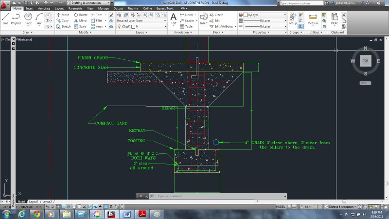

ConfusedStudent Posted January 31, 2015 Posted January 31, 2015 Good, bad or indifferent? I'm really trying to do my best even though I'm not sure the diploma will be worth anything when I'm done. I'm hoping the knowledge will be sufficient. Quote
ReMark Posted January 31, 2015 Posted January 31, 2015 For some reason the "J" bolt in the column baseplate and the keyway in the footing both caught my eye. Quote
ConfusedStudent Posted January 31, 2015 Posted January 31, 2015 Probably because I saw something that I like the look of for the bolt and did my best to replicate it. The keyway is spelled out pretty clearly in the directions. Quote
ReMark Posted January 31, 2015 Posted January 31, 2015 Most keyways I am familiar with are wider than they are tall. The "J" bolt does not appear to have the same width throughout. Maybe it's an optical allusion. Quote
ConfusedStudent Posted January 31, 2015 Posted January 31, 2015 Hmmm The instructions just say "A 2X4 keyway is centered at the top of each footing." I know a keyway is cut down into the footing but without a reference I just guessed. Thank you. I will check my widths but I hope it's an illusion. I used the offset command to do them. Quote
ConfusedStudent Posted January 31, 2015 Posted January 31, 2015 Keyways are modified. Thank you again. and I checked the J bolts they are the same throughout so it is an illusion thankfully. Quote

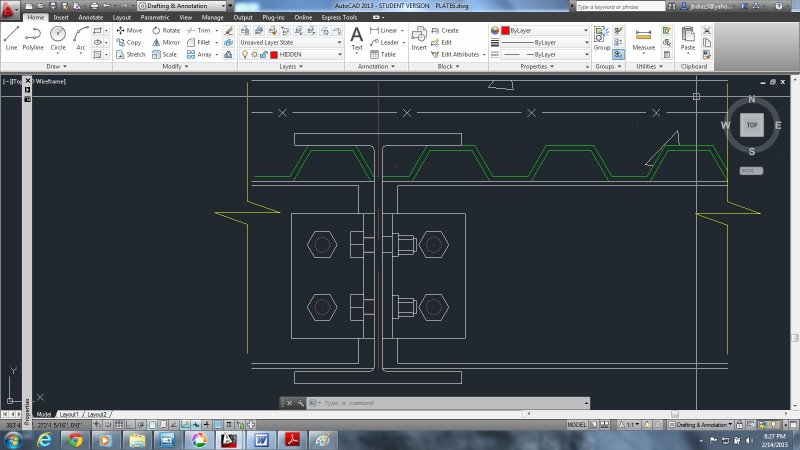

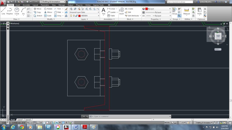

ConfusedStudent Posted February 2, 2015 Posted February 2, 2015 I'm having trouble with plate 6. Detail D is supposed to be connection B4. According to the way I've drawn this, that would be a connection of 2 I beams. Detail D1 they are asking to show the angle and connections. But those should not be connected at B4 - should they? I'm really confused. Quote
ReMark Posted February 2, 2015 Posted February 2, 2015 I'm pretty sure that an image of that detail is posted in one of the P-F structural threads. Quote
ReMark Posted February 2, 2015 Posted February 2, 2015 (edited) I'm having trouble with plate 6. Detail D is supposed to be connection B4. According to the way I've drawn this, that would be a connection of 2 I beams. Detail D1 they are asking to show the angle and connections. But those should not be connected at B4 - should they? I'm really confused. The connection is supposed to show two C9x20 angles connected to a single W12x45 beam using clips comprised of 4x4x1/2 angles and secured with 5/8" dia. x2 1/2" lg. bolts. The W12x45 beam, in turn, connects to a W12x152 column. In other words, the instructions in this case are correct. Take a look at this thread specifically page 13 post #125. http://www.cadtutor.net/forum/showthread.php?64167-Structural-Drafting-With-Autocad-help-with-the-last-3-plates Edited February 2, 2015 by ReMark Quote

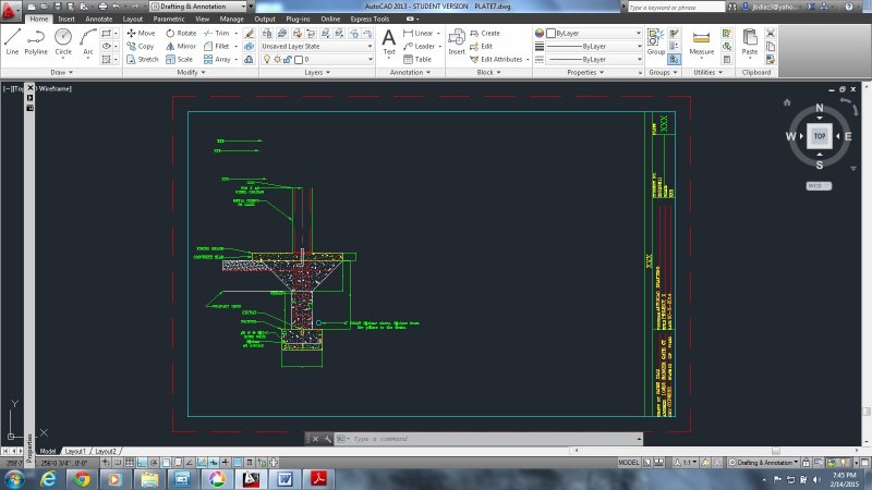

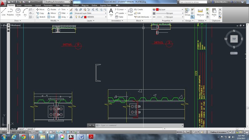

Hondatek Posted February 15, 2015 Author Posted February 15, 2015 Im stressing over the last two plate. On all the detail and dimensions. Ill post what i have on both plates Quote
Hondatek Posted February 15, 2015 Author Posted February 15, 2015 What can you help me with. Getting frustrated here. Quote
Hondatek Posted February 15, 2015 Author Posted February 15, 2015 I tried the civil and put it back down till i finish this one. Quote
ConfusedStudent Posted February 15, 2015 Posted February 15, 2015 Why do you have a c channel in the middle of plate 6? It's hard to tell but I think you're doing ok. You only have part of plate 7 done. Quote
Hondatek Posted February 15, 2015 Author Posted February 15, 2015 THE c9x20 DON'T LEAVE THAT THERE? Quote
ConfusedStudent Posted February 15, 2015 Posted February 15, 2015 Those look fine. I was talking about the one in the center of the page. It looks like it's in the middle of all 4 drawings. Quote
