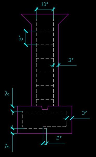

Hondatek Posted January 15, 2015 Share Posted January 15, 2015 Guys, I am having trouble picturing how this should look like. Page 11 in the book. The rebar in the bottom of the footings is #6 rebar at 8 OC both ways. The callout for the rebar is as follows: #6 Ø @ 8″ O.C. BOTH WAYS • There’s 3″ clear at the bottom of the footing and 3″ clear all around. Vertical and horizontal rebar is placed in the pillar similar to that shown in Problem 21-4, (page 45 in Structural Drafting with Basic Architectural Applications). This rebar is also #6 rebar at 8″ OC. The overlap of the rebar near the bottom of the pillar is approximately 2″. Quote Link to comment Share on other sites More sharing options...
Hondatek Posted January 15, 2015 Author Share Posted January 15, 2015 i can copy/screenshot the picture how do you post it? Quote Link to comment Share on other sites More sharing options...
ReMark Posted January 15, 2015 Share Posted January 15, 2015 To attach an image start by clicking on the Go Advanced button under the right hand corner of the Quick Reply window. At the next screen find and click on the Insert Image button. Should be smooth sailing from there as it operates pretty as the same feature would at any other website. BTW...that project has been discussed here in the past. Did you look at any of the other threads re: Penn-Foster structural project? Quote Link to comment Share on other sites More sharing options...
ReMark Posted January 15, 2015 Share Posted January 15, 2015 An example of what one former P-F student did. 1 Quote Link to comment Share on other sites More sharing options...

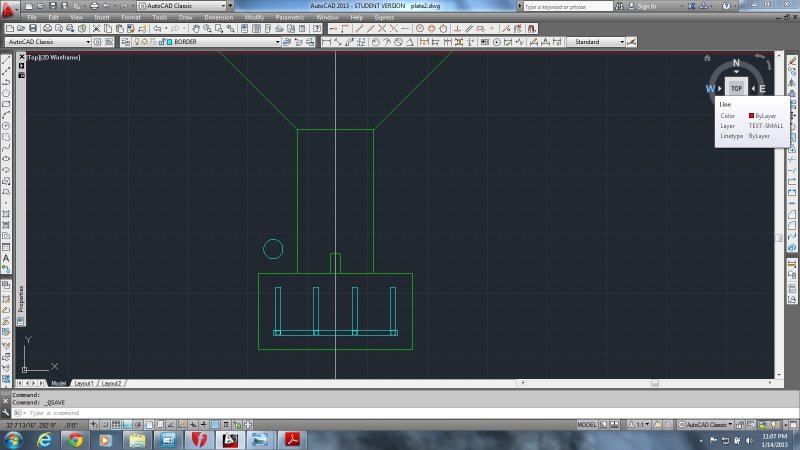

Hondatek Posted January 15, 2015 Author Share Posted January 15, 2015 This is what I came up with Quote Link to comment Share on other sites More sharing options...
ReMark Posted January 15, 2015 Share Posted January 15, 2015 Your keyway does not look right. Rebar is normally shown as a single line. Quote Link to comment Share on other sites More sharing options...

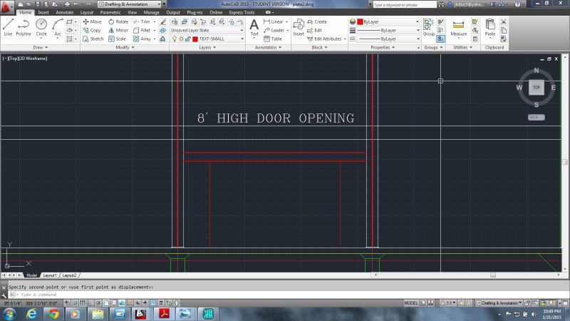

Hondatek Posted January 22, 2015 Author Share Posted January 22, 2015 Remark, How's this looking? OK so far? This has been a frustrating project. not as fun and enjoyable as the Olsen Village project. Quote Link to comment Share on other sites More sharing options...
ReMark Posted January 22, 2015 Share Posted January 22, 2015 There are two steel columns holding up the header. Unless those columns have no width (highly unlikely) you are missing a couple of vertical lines. Quote Link to comment Share on other sites More sharing options...
Hondatek Posted January 23, 2015 Author Share Posted January 23, 2015 Remark, here are the instructions. A supply entrance to the lower floor is on the building’s south side. It’s a sliding glass door centered between columns 3 and 4. The rough opening for the door is 12′ wide and 8′ high. Above the rough openings is a steel I-beam header, W10 × 45. The header is placed so that the flanges are horizontal and the web is vertical. The height of the header is 10 1/8″. so there is 2 flanges on each side? use the line that I have as a center line? correct? Quote Link to comment Share on other sites More sharing options...
ReMark Posted January 23, 2015 Share Posted January 23, 2015 They want you to set the bottom of the beam (header) 96" off the floor. Since the header (the W10) is seen from its side you will see four lines which represent the top and bottom edges of each of the flanges. I'm pretty sure if you read on there is a brief mention of the two columns that support the header inset from the main columns of the building. I can't check this at the moment as I am not on my CAD computer but I'm pretty sure there are images of the plate you are working on in at least one, if not more, threads re: Penn-Foster structural project. Quote Link to comment Share on other sites More sharing options...

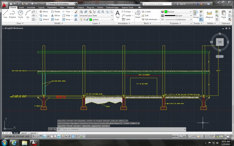

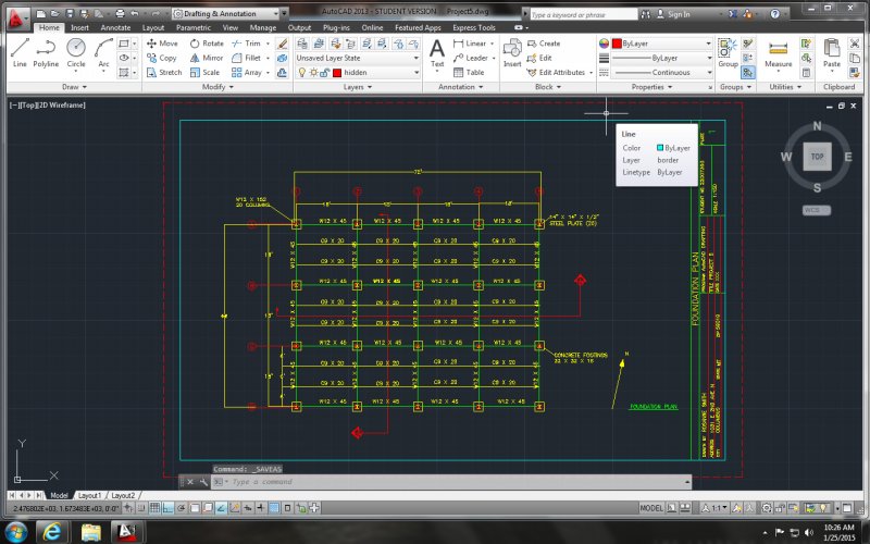

ConfusedStudent Posted January 25, 2015 Share Posted January 25, 2015 I have finished the first 2 plates for the structural drafting project but I can't download dwg files for help or feedback yet. So I will try a screen shot. I hope this works. Quote Link to comment Share on other sites More sharing options...
