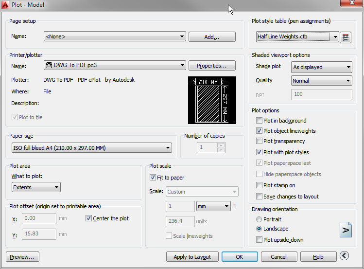

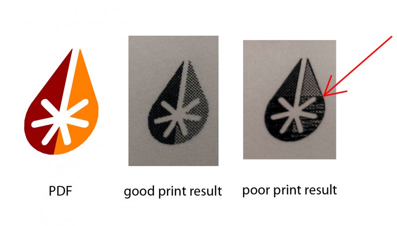

lamensterms Posted January 14, 2015 Posted January 14, 2015 Hi guys, I am getting some additional lines showing up over my hatches (mainly for logos), just wondering if anyone could please help me find a way to get rid of them. The lines seem to appear only on plots (hard copy) from PDFs created with DWGtoPDF.pc3. Hard copy plots directly from ACAD are clear/fine, and hard copy prints from PDFs created with PDFCreator are clear/fine. Please see attached image. Has anyone seen this behaviour before? Is there anyway to clear it up while maintaining the use of DWGtoPDF.pc3? Thanks a lot for any help. Quote
lamensterms Posted January 14, 2015 Author Posted January 14, 2015 (edited) Hi SLW210, Thanks for the reply. Please find attached a few files (DWG, PDFs & scanned prints). HatchTest.dwgFetching info... Hacth Test DWGtoPDF PDF.pdfFetching info... Hacth Test DWGtoPDF PRINT.pdfFetching info... Hacth Test PDFCreator PDF.pdfFetching info... Hacth Test PDFCreator PRINT.pdfFetching info... Here are my plot settings... Thanks again. Edited January 14, 2015 by lamensterms Quote

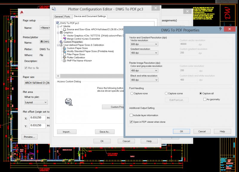

nestly Posted January 14, 2015 Posted January 14, 2015 In the Plot dialog box, Try clicking the Properties button to the right of DWG to PDF.pc3, then "Graphics" and then "Custom Properties" and increase the DPI settings. Quote
lamensterms Posted January 14, 2015 Author Posted January 14, 2015 Hi nestly, Thanks for the suggestion. I have tried both high and low resolution settings and the both produce the excess lines. Quote
rkmcswain Posted January 14, 2015 Posted January 14, 2015 Is transparency enabled in this page setup? Your screenshot says NO, but just wanted to make sure that was your actual page setup. I've seen transparency = ON cause problems with solid fills. Have you tried using a dense line (ANSI31) hatch, where the distance between the lines is slightly smaller than the printed line width? This will give you a solid fill. We had to do this with a logo because the solid hatch was giving us problems. Quote
lamensterms Posted January 15, 2015 Author Posted January 15, 2015 Hi rkmcswain, Thanks for the reply. I'm pretty sure there is no transparency enabled for these plots. How would I check that other than the check box in the PLOT settings? Also, the alternative hatch pattern does produce plots without the extra lines. But unfortunately this method has issues as well. With a hatch pattern (ANSI31) set just dense enough to seem solid, the edges of the hatch become jagged/pixelated (as formed by the ends of the lines), ie. it is not a smooth edge. If I increase the density of this hatch, it increases the PDF file size and also causes lag when viewing the PDF (zooming & panning). Not to sound ungrateful, but I would prefer an option without these pitfalls. Thanks again. Quote
SLW210 Posted January 15, 2015 Posted January 15, 2015 Printed pretty good here, the printed version actually looks worse on the scan than the actual printed copy. You didn't supply your CTB, so I think that has something to do with it or your printer driver. Of course, I am using AutoCAD 2011, maybe the newer version of DWG to PDF. Hatch Test- SLW210 DWG to PDF plotted.pdfFetching info... HatchTest- SLW210 DWG to PDF.pdfFetching info... Quote
Dana W Posted January 15, 2015 Posted January 15, 2015 lamensterms said: I'm pretty sure there is no transparency enabled for these plots. How would I check that other than the check box in the PLOT settings?There is hatch transparency setting adjustment in the hatch edit ribbon tab, but your properties have it set to zero, so that is not it. Using 2015, I also cannot re-create this condition. I selected dwg to pdf.pc3 and monochrome.ctb, I set the plot quality to maximum. pdf printed with no issues. Well, the edges look a little ragged in the pdf doc when dyn. zoomed in as far as it will go. This is due to the pdf software, and a conflict between line arc radii, line angle, and pixel size/shape. Nothing to do about it. What pdf viewer are you using? Quote
lamensterms Posted January 18, 2015 Author Posted January 18, 2015 Hi guys, Thanks a lot for all the assistance. I have now attached my CTB file. SLW210 - thanks for providing those test PDFs. I printed your version and the lines are present. So the issues seems local for me. Dana - I am using Adobe Reader XI. I tried printing an 'erroneous' PDF from an alternative reader - and the lines do not appear. So that suggests to me that it could be an issue (or setting) in Reader XI (and perhaps my printer drivers as well - maybe some sort of incompatibility). So, given the above theory... what PDF viewer do you guys use? SLW210 - did you print your PDF from Reader or an alternative? Thanks again. Half Line Weights.zipFetching info... Quote
