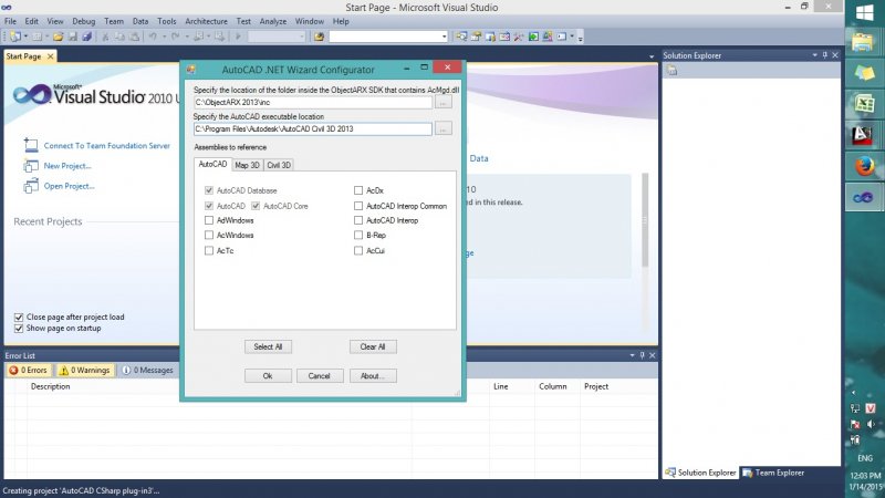

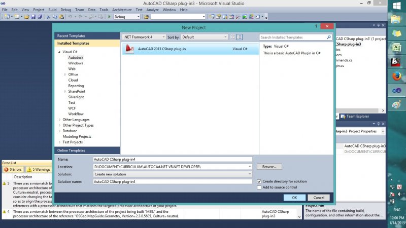

i run VS and creat project :
1. select "new project" -> select" visual C#-> "autodesk"->"autocad 2013 Csharp plugn in" click 'OK"
2.Click "OK"
3.New project ????

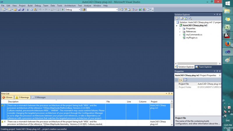

this is erorr, :(
Warning 1 There was a mismatch between the processor architecture of the project being built "MSIL" and the processor architecture of the reference "AecBaseMgd", "AMD64". This mismatch may cause runtime failures. Please consider changing the targeted processor architecture of your project through the Configuration Manager so as to align the processor architectures between your project and references, or take a dependency on references with a processor architecture that matches the targeted processor architecture of your project. AutoCAD CSharp plug-in3
Firstly, thank you for the screenshots.
In your last screenshot, in the Visual Studio toolbar (at top, below the menus) there are two dropdown menus - the left is 'Solution Configuration' which is set to Debug (this is normal), and the right is 'Solution Platforms' which is currently blank (empty; no selection) - try changing that to 'Any CPU' and let me know how that works for you.
Unfortunately, Autodesk's .NET wizards have never been entirely what we might expect, but they are simpler to pick up then doing it all yourself (until you know more about how you want things to be in your project template, that is). :thumbsup:
