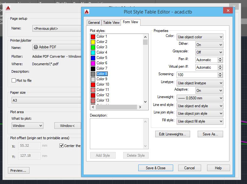

GemmaEBaird Posted January 10, 2015 Posted January 10, 2015 Morning I'm having problems with my ctb ..... everything is coming out at the correct line weights when printing - except the greys - even though I've set them. Any ideas ? Quote

GemmaEBaird Posted January 11, 2015 Author Posted January 11, 2015 Sorry - is it better like this ? Quote
Cad64 Posted January 11, 2015 Posted January 11, 2015 You say the grey's are not printing correctly? What does that mean? Are they printing too dark, too light, too thick, too thin? It might be better if you provide your actual ctb file, so we can load it and test it. Put it in a zip and upload it here. Quote

nestly Posted January 11, 2015 Posted January 11, 2015 Your screenshot shows the Color8 has a defined Lineweight of 0.05, Do the other colors have similar Lineweights assigned in the CTB, because the default setting for Lineweight in acad.ctb is "Use Object Lineweight", which is either set by the Layer Properties, or an Object Property override. Also, are you plotting 3D objects using 3D visual style, because Visual Styles also control how different types of edges are displayed. Quote
GemmaEBaird Posted January 11, 2015 Author Posted January 11, 2015 Yes - all the greys have the same lineweight of o.o5 - the colours have heavier weights but they are plotting fine. Its a 2D file so I'm not having 3D issues Quote

RobDraw Posted January 12, 2015 Posted January 12, 2015 Here's a stab in the dark. Is there any chance that the objects that are gray are polylines with width assigned to them? Quote

RobDraw Posted January 12, 2015 Posted January 12, 2015 nestly said: Are your "greys" Index colors ie 250-255 or True Colors such as 219,219,219? http://knowledge.autodesk.com/support/autocad/troubleshooting/caas/sfdcarticles/sfdcarticles/Objects-with-color-beyond-standard-255-do-not-plot-as-expected.html Did you miss this response? The link will provide you with an explanation as to what is going on. Quote
