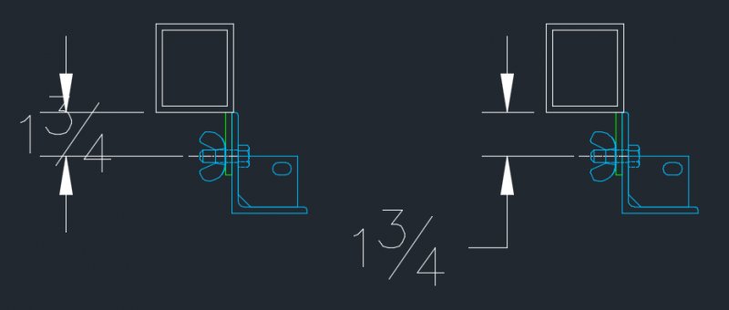

Thanks again all. I have run into one more issue with the dimension properties. Remember, these are placed on the fly, no user input or selection allowed. So I could use either entmake or just draw the dimension using command and then setting some properties for it as (entlast) or a variable I've assigned to it temporarily. But I'm stumped on how to format the text in a few dimensions due to space limitations. The image on the left is what I end up with by just drawing the dimension like this:
(command "._DIMLINEAR" pt1 pt2 "V" pt3 "")
But what I want is what is shown in the image on the right. I think I need to change the property "Text Inside" but not sure how to do this.

Good Day BIGAL. I think I found it by using the variable "DIMTIX" like this:
(setvar "DIMTIX" 0)
 (command "._DIMLINEAR" (polar (polar gp4 a270 (+ offsetdimV afrmdp1 1.75)) pi 1.4375)
   		 (polar (polar gp4 a270 (+ offsetdimV afrmdp1)) pi afrmwd)
   		 "V" (polar gp4 pi 9) "")
 (command "._DIMLINEAR" (polar (polar gp3 a270 (+ offsetdimV afrmdp1)) 0 afrmwd)
   		 (polar (polar gp3 a270 (+ offsetdimV afrmdp1 0.75)) 0 1.4375) "V" (polar gp3 0 4) "")
 (setvar "DIMTIX" 1)
The dimensions don't quite end up like I really want but at least I can set the smaller ones outside of the extension lines.

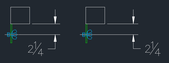

Just ran into one more thing with this issue. I can not control which dimensions are written outside of the extension lines but I need the text to be on the other side of the arrows. I know a lot of this depends on which dimension point gets picked first but the text still ends up on the opposite side of where I want it. See example below. The sketch on the left shows how the LISP code draws the dimension, the sketch on the right shows what I need it to end up looking like. I'm searching through that long list of DIMSTYLE variables and don't seem to find the one for that particular setting.
UPDATE: OKAY, many thanks again you guys. I found by playing around with the DIMJUST variable, this too can be controlled, on the fly.
