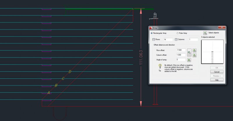

I tried to use Arrayclassic command to offset the stair run (13 runs) but with rectangle array, i am only able to offset them verticle, is there a way that i can offset those step 7.9375" rise to intersection of point A, B,C,D............so on as shown on pic??, i can copy with base point manually but just wonder if there is any other easier tool to use. appreciate any suggestion.

Reorient the UCS so it's aligned with the stair stringer angle, then use the "Pick column Offset" button and Osnap to set the offset distance in the new UCS using the Intersect Osnap
awesome Nestly, took me a few time but finaly got it, one question though, if i don't want to type "UCS" where can i find it on the ribbon? Thanks so much

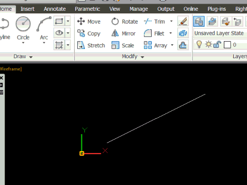

UCS options are on the View Tab, however the UCS icon in 2014 is directly editable, so you can click on it then right-click, or you can just select it and adjust it by using it's grips, just like any other object

Also, just hovering over it and right clicking gives you the UCS commands.
I forgot about the hover menus. I think it's actually been that way since 2012, but rarely use the dynamic UCS icon because I think I'm quicker just keying in the command rather than right-clicking and/or dragging it around, but it's definitely nice to have all the UCS commands right on the Icon vs picking them from a toolbar or finding them on the Ribbon.
