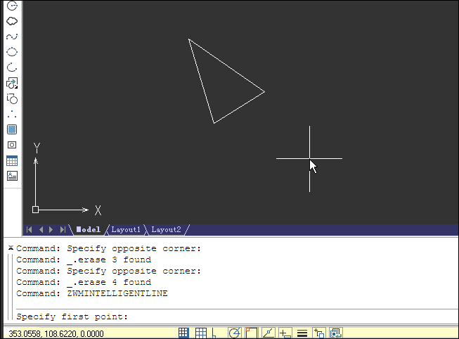

cadfan Posted January 5, 2015 Posted January 5, 2015 (edited) I know how to draw a line with angle (@length But ,here ,I mean : when drawing line , can pick another line(target line) , Enter the angle ,This angle between the line and the reference line . if Enter the angel is: 0 ,so this line PARallel the target line , if Enter the angle is : 90 , so this line PERPendicular the target line. Of course also can enter the other Angle. Can do this use Vlisp ? If some one have free time and interested write it , I would be very honored and grateful!! Edited January 7, 2015 by cadfan Misunderstood! Quote
rkmcswain Posted January 5, 2015 Posted January 5, 2015 Not quite sure what that is doing. AutoCAD has a PARallel object snap, as well as polar tracking and a few other aids that I suppose can do what you want. Can you explain exactly what it is you want to do? Quote
cadfan Posted January 5, 2015 Author Posted January 5, 2015 Not quite sure what that is doing.AutoCAD has a PARallel object snap, as well as polar tracking and a few other aids that I suppose can do what you want. Can you explain exactly what it is you want to do? YES , autocad can snap ,but can't specify a angle with target line. can use lisp to do ? Quote
rkmcswain Posted January 5, 2015 Posted January 5, 2015 but can't specify a angle with target line You can if you want to make a line PARallel to an existing line, or PERPendicular to an existing line. Quote
cadfan Posted January 6, 2015 Author Posted January 6, 2015 You can if you want to make a line PARallel to an existing line, or PERPendicular to an existing line. yes ,I know ,can input Keyword “per” and "par" to do this ,bat can't specify a angle ! I think vlisp can do this , someone can write a Sample ? Quote

ReMark Posted January 6, 2015 Posted January 6, 2015 There is no AutoCAD command that will mimic the angle of another line while in the line command on-the-fly. You could use the SNAPANG command to set your crosshairs to duplicate the angle of the line however I doubt that you'll find this as quick as the feature you have demonstrated in Zwcad. Quote

Dana W Posted January 6, 2015 Posted January 6, 2015 That is true, the angle has to be known firstThat is, unless one is using the parallel snap. Then mimicking another lines angle is automatic exactly as in the ZWcad example, hover over the reference line to acquire tracking, move the cursor until the "H" lights up, and click. Quote
