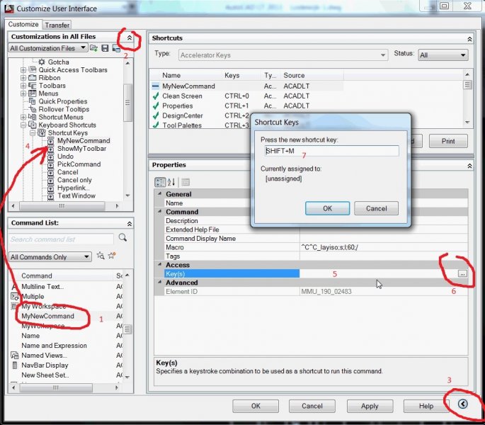

steven-g Posted April 29, 2015 Posted April 29, 2015 I managed to figure out how to write a Macros to get the LayIso for LayIso -> Off. I made a custom command for it, put it in my panel, and it works like a charm! (I still need to add a shortcut, though... is there anyway to add a keyboard shortcut via the CUI menu where I put in the macros? Or do I need to go to the txt document Manage Aliases and add it there?)^C^C_layiso;s;o;o;/ To use this as a keyboard shortcut, it depends on where you have the macro, I often create, test and use macro's directly from a toolpalette, or they are more normally made in the cui. From the cui 1 - drag the new command up into the menu structure and place it somewhere under the 4 - Keyboard Shortcuts - Shortcut Keys in the customisation files tree (you might need to click on the arrows at 2 & 3 to expand the cui 5 - just click into the box Access to make it active and - 6 - click on the elipsis [...] which opens up a Shortcut Keys dialogue 7 - enter your keyboard shortcut here, it does have to be a key combination with either Shift Ctrl or Alt, or multiples of those, it will tell you if that choice is already in use, or you can look in that section just above the shown dialogue that list all the active shortcuts Then click on Apply and exit out of the cui, you can always change your shortcut keys later (or delete it), or edit the macro if needed Quote
