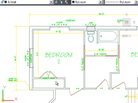

jvanabel Posted December 31, 2014 Posted December 31, 2014 I am having a problem with my trim and extend... I tried drawing closer to 0,0 and checked my PROJMODE with negative results. I have played with the Fence, Crossing, Project, and Edge commands within TRIM and it is still the same. For example, when I trim the walls/lines from (will call it Object 1), most of the time it trims the walls/lines from Object 1 well past the nearest apparent intersecting line, if not all of the wall/line. This is the same with all lines/block combinations. When I note that the TRIM function isn't functioning, I will extend the line that should have been trimmed to and it will extend right past Object 1 which tells me that they were already touching or intersecting. I have gone as far as setting my units to the 264th precision to ensure that the start and finish on the X or Y axis are the same, used the ALIGN command, etc to ensure everything is parallel and/or perpendicular which they are. These are old blocks, and this whole process used to work like butter! Any thoughts? Quote

jvanabel Posted December 31, 2014 Author Posted December 31, 2014 pocket door that is vertical. When I TRIM, I click and drag across the operating part of the door that I wish to trim walls and it takes the entire left wall but trims the right side just fine. Quote
jvanabel Posted December 31, 2014 Author Posted December 31, 2014 left vertical pocket door that is not trimmed. Quote
jvanabel Posted December 31, 2014 Author Posted December 31, 2014 I copied and pasted that wing of the house to show, saved it as above titled, saved it, just opened it and it is still doing it on both drawings. Quote

jvanabel Posted December 31, 2014 Author Posted December 31, 2014 here is another problem I have on that drawing... go to the stairs, the flight without the 'UP' arrow, far left stair tread. Delete it. Now, the small section of wall that was under it, extend it south. Did it shoot right past the perpendicular wall/line below? Mine did. Now, extend that perpendicular wall/line to the left past the line you just extended. If it goes past it, that means they are joined or touching, which means why didn't the first extended line coming down stop at that perpendicular line? Quote
nestly Posted December 31, 2014 Posted December 31, 2014 I believe the problem is that your geometry does not actually intersect precisely. You mentioned that you increased your precision to the highest Architectural unit, but that's not enough to detect small inconsistencies. Using the leftside pocket door as and example, since there is no physical intersection on the lower side, and EDGEMODE=0, the inside wall cannot be trimmed to the lower side of the door until the inconsistency is corrected Quote

jvanabel Posted December 31, 2014 Author Posted December 31, 2014 I just tried duplicating what you are doing in this video and after I select the two vertical green door jambs, then enter, then click the bottom wall/line and it takes it out from the right jamb all the way to the left... past the other jamb... Quote
nestly Posted December 31, 2014 Posted December 31, 2014 From what I can tell, the reason TRIM is removing the entire wall is because there is no actual intersection between the horizontal line representing the lower edge of the door and the vertical line representing the inside wall. (the gap is approx. 0.00018 ) Quote
