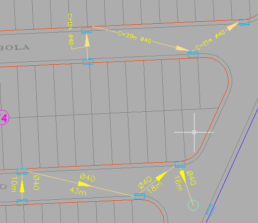

Madruga_SP Posted December 30, 2014 Posted December 30, 2014 Hi guys, I was wondering if is possible to set the arrow in the middle of the line instead of the endpoint. Regards Aligned dimension.pdf Quote

nestly Posted December 30, 2014 Posted December 30, 2014 I am interested to know how you got the arrowheads in the middle of the dimension line, especially where doing so also required the dimension text above and below the dimension line to be offset farther from the dimline. Posting the drawing would be helpful. thanks Quote
Madruga_SP Posted December 30, 2014 Author Posted December 30, 2014 Hi, I'm attaching the file with the both ways. HTH test.dwg Quote
nestly Posted December 30, 2014 Posted December 30, 2014 That answers my question about how you got the arrowhead in the middle. It's not a dimension, it's a dynamic block with a arrow symbol and text labels. thanks Quote
Madruga_SP Posted December 30, 2014 Author Posted December 30, 2014 Guys, How Can I set the aligned dimension to remove the last command (Specify dimension line location or [Mtext/Text/Angle])? I'd like to just put start point and endpoint and the text fits in the middle of the line. Is it possible doing that? Quote
Dana W Posted December 30, 2014 Posted December 30, 2014 Yes, click twice on the end point. That sets the dimension line location on top of the end point rather than pulling it up to show extension lines. The text will land wherever your dimension style set up says it is supposed to go. (unless you have set your dimension style options to "Manually place text") OR, if you want same length extension lines for every dimension, that can be set in the dimension style editor as well. Quote
