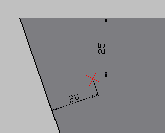

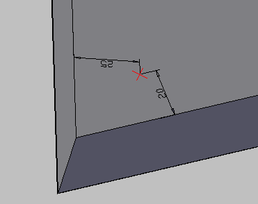

I want drawing a point on 3d solid.
step.
1. pick a face of 3d solid (point on this face)
2. pick a reference edge and enter the distance value.
3. pick another reference edge and enter the distance value.
4. draw a point (PDMODE=3 PDSIZE=3.0000)
maybe can use "copy edges" ,After the drawing point complete, delete this edge ?

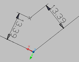

Hi henrique .
Thanks so much! nice routine !
There is a small problem.
I enter the distance value is "15" , But the actual value is wrong.
Hi AIberto,
the code in post #3 should work as expected, code was revised, but not tested...

Thanks Henrique , now, the distance value is right.
"There is no point at provided data..." How about this mean ?
You're welcome, AIberto.
The "There is no point at provided data..." it's a message to display if user select parallels edges, in this case the intersection will be impossible...
Henrique
Henrique
if select parallels edges will be display "Selected edges don't have a common point.." , not display "There is no point at provided data..."
You are correct, that msg is the return from the test 'cond' if there is no common point from the two edges.
The another msg is from the 'mk_pt' function to throw if there is no return from the 'IntersectWith' function.
