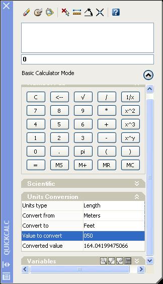

Have you ever needed to convert Meters to feet? AutoCAD has a built in coverter. At the command line type quickcalc this brings up the calculator. look down twards the bottom and you will see some options, one is Units Conversion

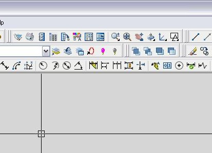

Part screen shot of three simple buttons that I have found useful:
set layer 0
^C^C-layer set 0;;
turn viewport off
^C^C-layer off vport;;
turn viewport on
^C^C-layer on vport;;
