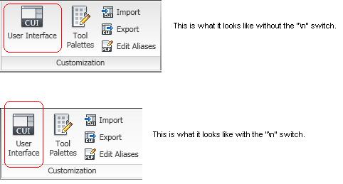

The LISP new line switch can be used in the CUI for making the text in buttons multiline.
For example typing "User Interface" into the name box of the button/command will display the name on one line.
  Quote
User Interface
Typing "User\nInterface" into the box will display the text like:
  Quote
User
Interface
See the attached image for further clarification.

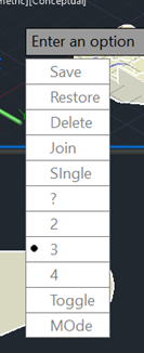

Navigating 3D modeling is quite hard with a single window, sometimes we wish we have multiple monitors to see things in different angles. To create a split screen (similar to 3DSMax -plans, elevations, perspective in one window), where you can view 4 or more windows simultaneously, you can use the command -VPORTS or access this option in the View Tab.
You can check more about this functionality here: https://allaboutcad.com/draw-with-tiled-viewports/
-Chris

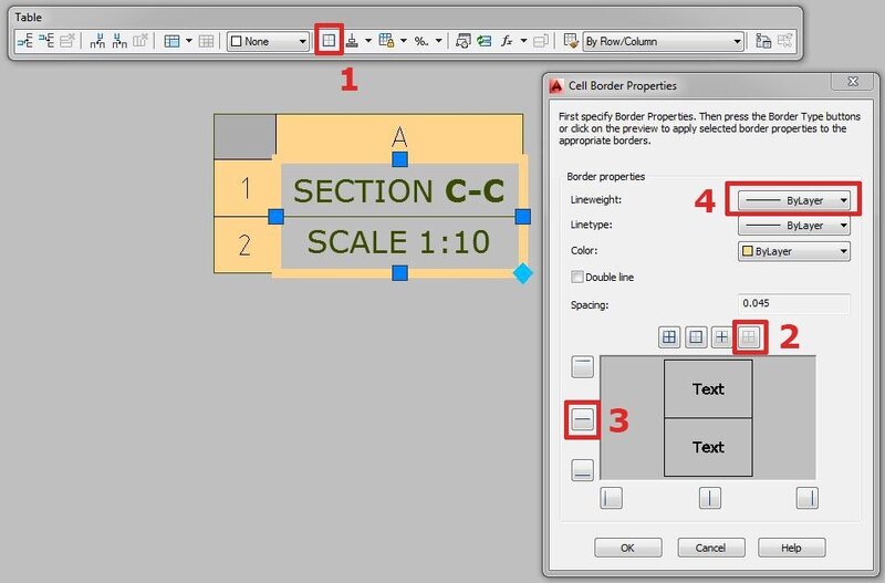

View/Section annotation tip
For your consideration a tip for various annotations one might need in a drawing (views, sections, details etc.). Usually those are made either with lines/polylines and text/mtext or as blocks with attributes. Both solutions do work for most cases. Though the former is just a bunch of separate objects that has to be edited separately and might require manual adjustments (for each individual instance) to look properly, the later has its own limitations in what can be done in the text formatting department (i.e. attributes do not support bold or italic text) and if any lines are used to underline/separate text horizontally, those can only be adjusted with a dynamic block.
The proposed approach involves a table object. Tables, in some respects, behave like a dynamic block with attributes, but are way easier to create and edit. Plus tables offer much more options in terms of text formatting (not to mention the capability to perform calculations). Thus we could have a block-like object that is easy to modify and edit according to specific needs.
HOW-TO
  1. Create a table object with a single column and two rows (adjust cell margins and text alignment according to your taste)
  2. Select the table and then select both rows
  3. Then click the border editor button (1)
  4. Click No Border button (to remove all the border lines) (2)
  5. To simulate the underlined text effect, click the middle horizontal line button (3)
  6. Optionally you might want to adjust the underlined text line thickness (4) or other properties. This should be done before clicking the horizontal line button (3)
  7. Click OK

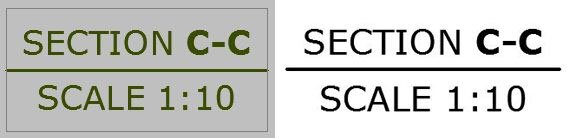

Now you should get something like this (left - in the model space, right - in the layout print preview).
To take things even further, one could also add a block to the table (as it is possible to insert a block in to the table cell). In the image bellow a column was added (to the left of the text), rows in that column were merged (to form a single full height column) and a block was inserted. Note that vertical borders of the cell with the block were set to 0 in order to align the block with the horizontal line separating both text objects.
There could probably be other ways to use this approach. Enjoy!
