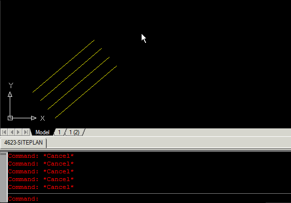

I just stumbled across this by accident. I'm sure many use the Lengthen command and it's vast options. I use Delta, Total and Dynamic myself, quite a bit - even have LISP macros for each.
eg.
;LENGTHEN (TOTAL)
(defun c:LG (/) (princ "\nLengthen Total") (command "lengthen" "t") (princ))
;LENGTHEN (DELTA)
(defun c:DE (/) (princ "\nLengthen Delta") (command "lengthen" "de") (princ))
;LENGTHEN (DYNAMIC)
(defun c:DY (/) (princ "\nLengthen Dynamic") (command "_.lengthen" "_dy") (princ))
But, I never noticed that you can type "F" (Fence) when prompted to select the line and you can fence through multiple lines and Lengthen them all at the same time.
You can use the fence command in many situations where you have to pick an object, and its normally not documented. Its worth trying it out in other situations too.
