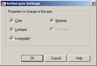

alanjt Posted May 11, 2010 Posted May 11, 2010 You can use the SetByLayer command to fix object level (color, etc.). Also, it has the option to fix any objects created within a block that are NOT set to ByLayer. eg. Command: SETBYLAYER Current active settings: Color Linetype Lineweight Material Select objects or [settings]: Specify opposite corner: 1 found Select objects or [settings]: [color=Red]Change ByBlock to ByLayer? [Yes/No] <Yes>: Include blocks? [Yes/No] <Yes>:[/color] Quote

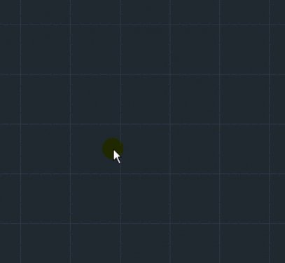

troggarf Posted March 25, 2011 Posted March 25, 2011 With AutoCAD 2012, As you type in a command it will populate a list of commands that start with the same characters (letters or numbers). In this list are commands, aliases and systems variables. But there's a function that is annoying called "Auto-Append". After the third character is entered, it will guess what command you are entering and fill in the remaining command for you. This sounds like it would be great, but it's actually annoying. To turn "Auto-Append" off: Start entering a command and as the list of commands populates, Move your cursor over the list and right-click Uncheck "Auto-Append" To see the animated GIF that shows this feature: go to the Autocad Tips blog Quote
