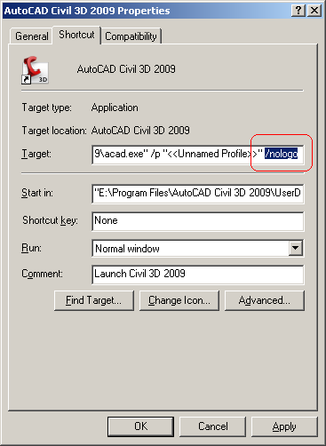

If you right-click on your AutoCAD icon and select properties, you can add "/nologo" to the end of the Target portion and the Autodesk splash screen will no longer display. It's not much, but it's a slight increase in start-up time.

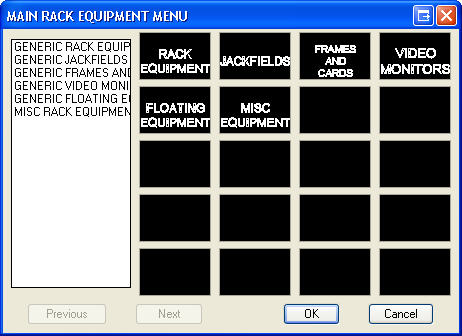

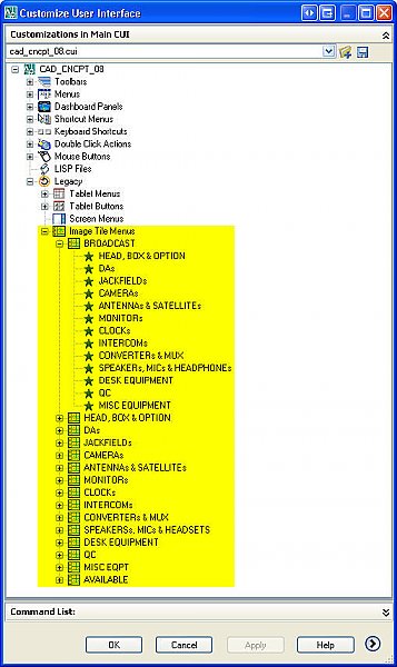

If you use Image Tile Menus,
By default the menu the pops up is relatively small:
You can see that the displayed names in the left pane are clipped.

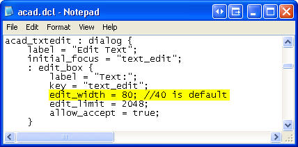

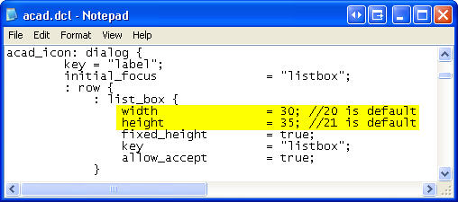

The first is the acad.dcl. Open this file in notepad and change the following items...
and

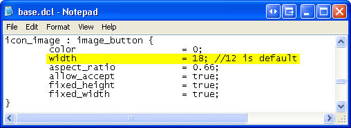

Next open the base.dcl with notepad and change the following item...

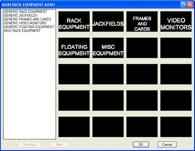

Doing this will increase the size of the Image Tile Menu...
Back up your .dcl files first. Obviously, you can play with these values to achieve you desired results. This also works for AutoCAD LT.
Hat tip to Warren Trost, who posted this tip in 2008 buried in a thread about library viewers in the Autodesk Discussion group.
