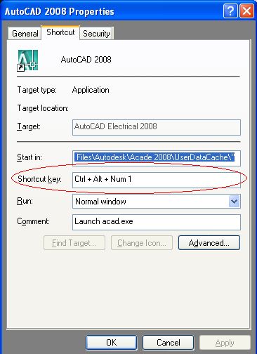

todouble22 Posted March 16, 2010 Posted March 16, 2010 Here's a handy tip if some of you are like me and don't like a cluttered desktop. You can define shortcut keys to start programs by right clicking on the icon and assign shortcut keys to them. I've assigned mine for programs that I always use so I can start them anytime without having to go back to my desktop. Here is an example for Autocad. Quote
