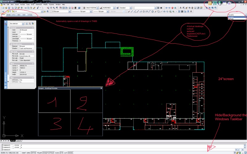

Attila The Gel Posted January 21, 2009 Posted January 21, 2009 I accedently found out that you can also multi-copy this way: Click on a grab point then hold your ctrl-key and click somewhere els! now you can let go of your crtl-key and still continiue to copy. If you select an endpoint of a line you can stretch-copy this way! This works better for me. Quote
Attila The Gel Posted January 21, 2009 Posted January 21, 2009 luther4000 said: FOr that you just need to adjust the TASKBAR system variable between 1 and 0. One value will keep all drawings in one TAB the other will keep each one on a separate one iin the taskbar. - I hide my taskbar and set it to background so when I go to the bottom of my screen with my mouse the taskbar doesn't pop up. this way i can use my hole sreen.(Taskbar pops up when you press the windows key on you keybord.) - 4 vertual desktop with Dexpot: Outlook Autocad Internet (CadTutor :-) Filebrowser - The cl-DWGman helps me out with tabs for each drawind I open. Quote

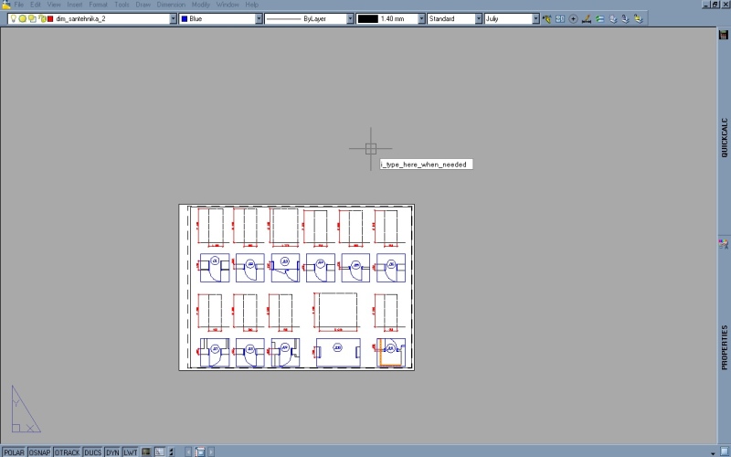

antant Posted February 27, 2009 Posted February 27, 2009 speaking of using 'my hole screen' my windows taskbar is hidden and is vertical on the right of the screen, my autocad window is in 'clean screen' mode (ctrl+0) and my saved workspace is enabled, providing the custom monobar with the 6 controls i need, and the 8 buttons that i dont want to map a hotkey to. besides standard hotkeys (e.g. ctrl+x) i use combinations like alt->f->x for 'file exit' or alt->d->u for a 'revision cloud' etc. i also use DYN so that i can hide the console (ctrl+9) tell me if you manage to free more than that =) p.s.: this is a fullscreen grab, not a window grab or smthing. this is actually what's displayed on my monitor Quote

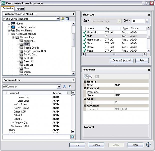

Biscuits Posted March 19, 2009 Posted March 19, 2009 In using Acad2008, I've assigned "Midpoint between 2 Points" (M2P) to my F1 key. Great time saver and no more annoying "Help" screen pop-ups Quote
