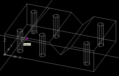

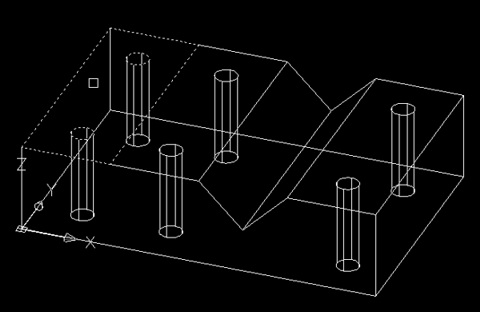

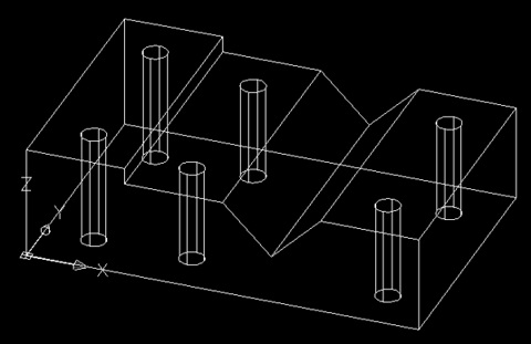

SEANT Posted February 16, 2007 Posted February 16, 2007 Imprint to Sub-divide Face The “Imprint” command (Modify-Solids Editing-Imprint) gives the first impression of nothing more than adding graffiti to solids. Upon closer investigation, however, we find that it actually modifies the face on which it is placed. Here, I’ve created a “Sub-Divide Face” procedure. A line is drawn at the seam and imprinted on the solid. This new face subdivision is then “Extrude Face”ed (Modify-Solids Editing-Extrude Faces) to generate the addition feature. To generate this modified part with Boolean operations would not be difficult but, as we all know, speed and accuracy are the name of the game. The procedure describe above can be auto-executed with the command macro: ^C^C_line;\\;_solidedit;b;i;\last;y;;;f;E;\;\\;; The UI could benefit from some advanced programming, but if one pays attention to the Command Prompts it’s not so bad. Quote
