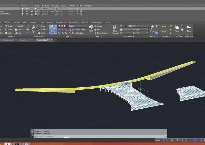

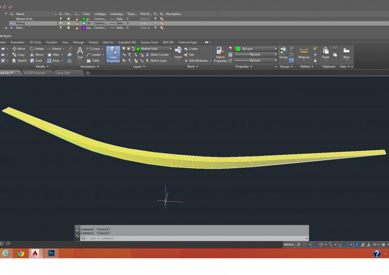

ReMark Posted December 20, 2014 Posted December 20, 2014 The same way I've mentioned previously (twice) via extruded profiles. It's possible you are getting a different result because your side profile is tilted just ever so slightly. Quote
GemmaEBaird Posted December 20, 2014 Author Posted December 20, 2014 Hmmm - I am definitely doing it that way. The difference I'm seeing is that both your top and bottom lines are parallel - and mine are at a different angle to each other Quote

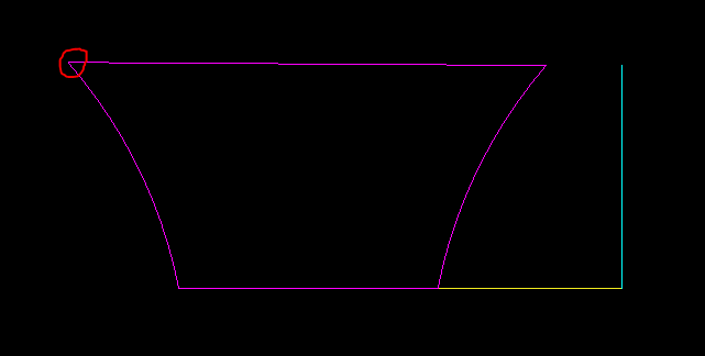

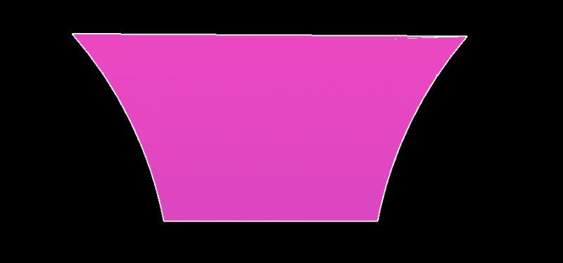

ReMark Posted December 20, 2014 Posted December 20, 2014 (edited) Maybe you should rethink your design. I have to call it a day in a moment but before I do I believe I was able to solve the dilemma by rotating my side profile to match that of the angle of the front edge. A top view of my ramp. Note the end circled in red. It extends 500 units beyond its counterpart on the other side thus creating an angled front edge. Top view of resultant solid with angled edge. Sorry, but my time is up. I'll check this thread tomorrow (Sunday) morning after I've had a cup of coffee (or ten) to clear my head. Good luck. Edited December 20, 2014 by ReMark Quote
GemmaEBaird Posted December 20, 2014 Author Posted December 20, 2014 Its not my design - its an existing overpass Quote
GemmaEBaird Posted December 21, 2014 Author Posted December 21, 2014 Thank you for all your help. I see your point - but the two ends are at different angles to each other so unfortunately this isn't going to work. It's past midnight here so I'm off myself. Quote
ReMark Posted December 21, 2014 Posted December 21, 2014 I disagree. In the last two images posted the two ends are NOT parallel to each other. I think it can be done you just have to work at it some more. Quote

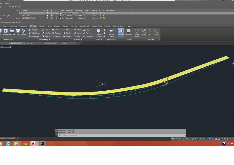

nestly Posted December 21, 2014 Posted December 21, 2014 ReMark said: I disagree. In the last two images posted the two ends are NOT parallel to each other. I think it can be done you just have to work at it some more. I think you're looking at the wrong part of the drawing. OP said the curved overpass 9M high, in front of the 3D structure. I'm not exactly sure how to solve it myself, but made a spline starting at the left end of the overpass, then progressing to the right to the 6500 elevation line, then the 9M line (9000 elevation) then to the 6000 elevation line, then back to grade at the right end of the ramp. Repeat for the other side of the ramp, then LOFT. Unfortunately, this is just a rough concept of how it may be done, as there aren't enough control points to make the spline follow the exact curvature of the ramp. Quote
ReMark Posted December 21, 2014 Posted December 21, 2014 Still don't see it as being an insurmountable problem. Wouldn't the ramp be banked? Quote
GemmaEBaird Posted December 21, 2014 Author Posted December 21, 2014 ReMark - I'm pretty sure it can't bank as it is a road. nestly, that works ! - except how do I now give it a thickness, and solidity from the 6500 point down to the ground ? Quote

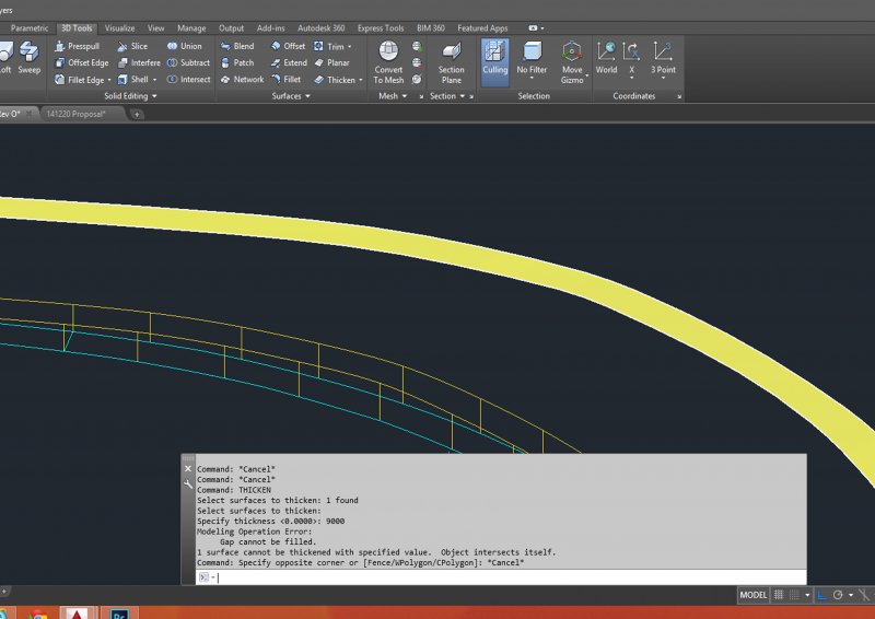

nestly Posted December 21, 2014 Posted December 21, 2014 You can try THICKEN command to turn the surface into a solid. Give it a thickness of -9000 (or whatever it's highest point is above the beginning/ending elevations), then SLICE off anything below 0 elevation. Quote
GemmaEBaird Posted December 21, 2014 Author Posted December 21, 2014 That doesn't seem to work - with + or - Quote
nestly Posted December 21, 2014 Posted December 21, 2014 OK... Thicken didn't work for me either on that surface. Copy the surface down 9000 units, then LOFT the two Surfaces (try using the MOde > Solid option) If it doesn't loft a solid, use SURFSCULPT command to turn all the surfaces into a Solid, then SLICE off what's below grade. Quote
GemmaEBaird Posted December 21, 2014 Author Posted December 21, 2014 AMAZING It worked !!!!!! Now I just need to work on the void below - but I'm pretty sure I understand that concept Thank you Quote
GemmaEBaird Posted December 21, 2014 Author Posted December 21, 2014 So I've cracked it with all of your amazing help. It's not quite finished - but the main form of the bridge is there THANK YOU !!! Quote
