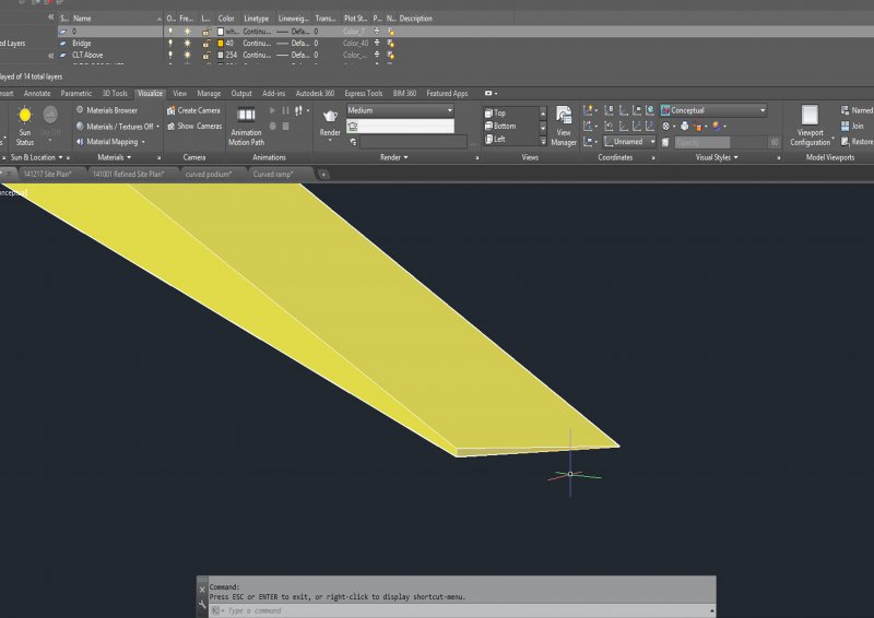

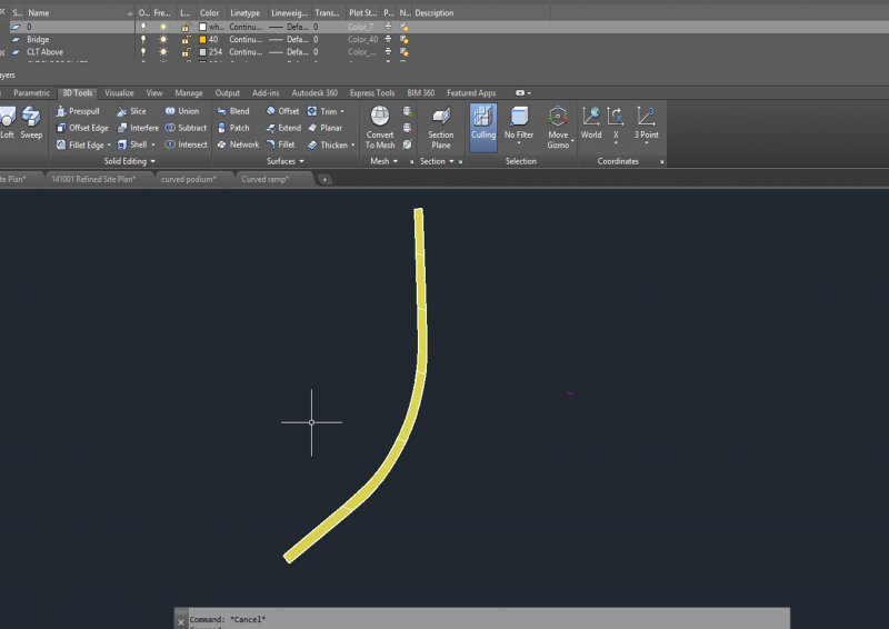

GemmaEBaird Posted December 20, 2014 Posted December 20, 2014 I am fairly new to 3D and am having problems with a curved overpass. It begins at ground level and curves both in plan but also elevation to reach 9m at its highest point. I just cant work out the concept of creating such a form. Anny help would be much appreciated You can see the plan of the bridge in front of the 3D structure. Thank you Bridge.dwgFetching info... Quote
ReMark Posted December 20, 2014 Posted December 20, 2014 My initial response, without seeing your drawing, would be to suggest creating a plan view profile and a side view profile then extrude both. Run the INTERFERE command and the intersection of the two profiles should result in a curved bridge. Can't be 100% sure of this approach until I try it myself. Quote
GemmaEBaird Posted December 20, 2014 Author Posted December 20, 2014 Thank you ReMark, but the two sides have a different profile as it curves in plan too ....... so I can't make that work. I've attached my drawing - and a screenshot if that helps. Any other ideas ? Quote
ReMark Posted December 20, 2014 Posted December 20, 2014 I don't see that as being an insurmountable problem. The plan view profile could be drawn as though both sides were the same then slice away the portion you don't need. Quote
GemmaEBaird Posted December 20, 2014 Author Posted December 20, 2014 I understand that bit - but how do I get the curve the other way ? Quote
ReMark Posted December 20, 2014 Posted December 20, 2014 At the very least you would need a top and side profile. Another option might be the use of sequential profiles and the LOFT command. Quote
GemmaEBaird Posted December 20, 2014 Author Posted December 20, 2014 Sorry - could you explain a little more please Quote

GemmaEBaird Posted December 20, 2014 Author Posted December 20, 2014 Ok - that makes sense ive sort of got it but with one problem ...... Quote
GemmaEBaird Posted December 20, 2014 Author Posted December 20, 2014 where it hits the ground it has a sort of step where it turns a corner Quote
ReMark Posted December 20, 2014 Posted December 20, 2014 ^^^Not sure exactly what you are referring to. Do you want to add this "step" or delete it? Quote
GemmaEBaird Posted December 20, 2014 Author Posted December 20, 2014 delete it - the bridge should come down flush with the ground Quote
ReMark Posted December 20, 2014 Posted December 20, 2014 Not sure how you got it to be higher on one side than the other to begin with. I only know of two solutions. 1) Do it over. 2) Cut off what you don't need using the SLICE command. Sorry, but I have to step away from my computer again. May be about 15 minutes or so. Time now is 5:42 p.m. Quote
GemmaEBaird Posted December 20, 2014 Author Posted December 20, 2014 the issue is - in plan he 2 ends of the bridge aren't parallel - so when creating the elevational plane to trim it by the arc is slightly higher at the more narrow side of the curve ....... if that makes any sense at all Quote

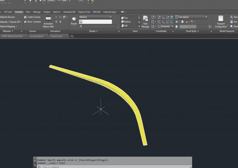

ReMark Posted December 20, 2014 Posted December 20, 2014 In plan the ends of my ramp aren't parallel either yet I maintain a uniform thickness throughout. I guess I'm not "seeing" why you should have a problem tapering the end of the ramp to the point of where it is for all practical purposes flat. Quote
GemmaEBaird Posted December 20, 2014 Author Posted December 20, 2014 I must be doing something wrong - I'm just not sure what Quote
ReMark Posted December 20, 2014 Posted December 20, 2014 My curved ramp but this time I've tapered one end. Note that it is flat across the entire width. Quote
