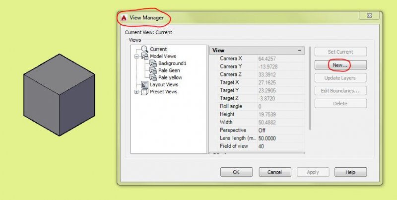

The View Manager.

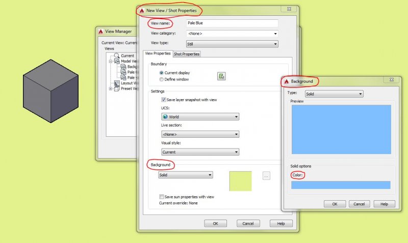

New View / Shot Properties & Background windows.

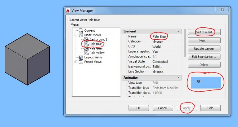

After making our choices and back in the View Manager.
Between this post and the previous one I think you should be good to go.
