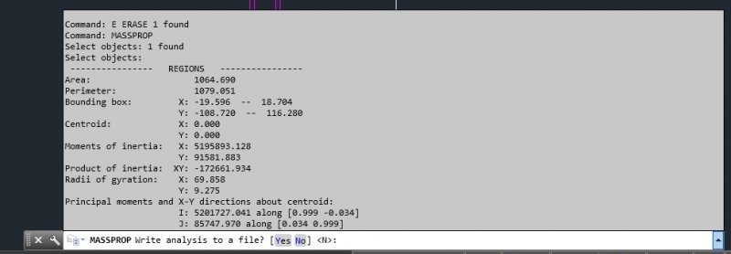

Is there a way of writing a selected amount of the command line history to a file via a lisp routine?
An option to write analysis to file pops up when using the MASSPROP command (see attached screenshot). I wondered if it was possible to replicate something similar for lisp results that come up on the command line. massprop screenshot.jpg
Thanks in advance.
