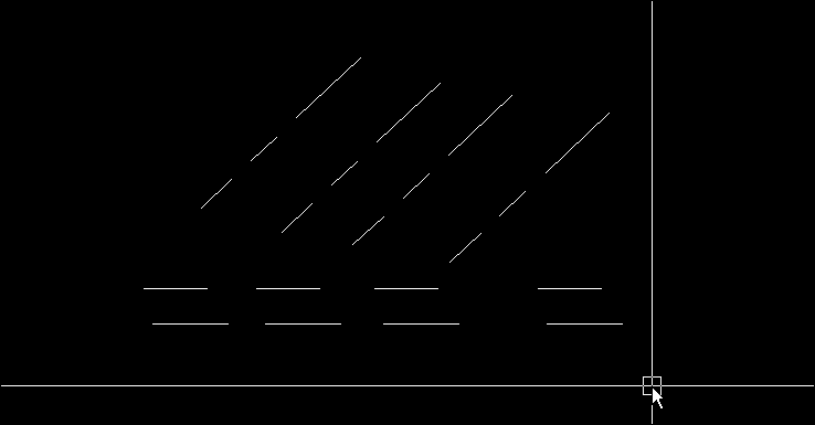

Hi guys
Can help me to supplement the "dot" function ? Thanks a lot!

Thank you so much , marko. but , can't batch join .

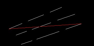

I thought you wanted something like this :

Regards, M.R.

No, this is not I want. This can't batch merge Lines .
