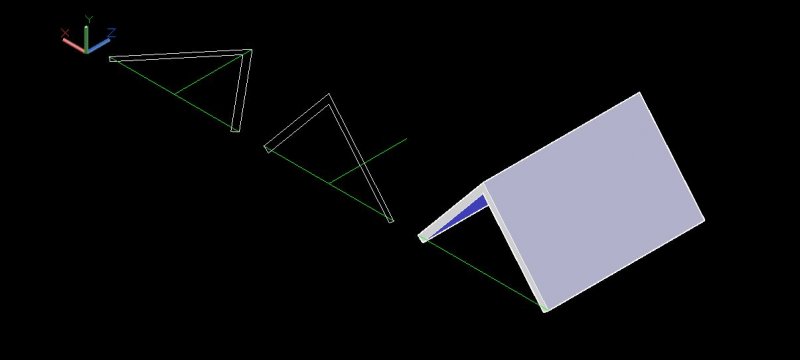

ReMark Posted December 11, 2014 Posted December 11, 2014 Example of a 3D roof created by extruding a single, continuous, polyline profile. Draw it flat. Rotate it. Extrude it. You just have to know how to change the orientation of your UCS. Or.... Draw it flat, extrude it THEN rotate it. Either way the result is the same. Quote

ReMark Posted December 11, 2014 Posted December 11, 2014 Look at my roof profile. It isn't a rectangle; it's an upside-down "V". Your method involves more work; mine involves less. Who do you think will finish first? Quote
idk14 Posted December 11, 2014 Author Posted December 11, 2014 So let me understand, you first made a simple upside down V then simply rotated it and from "V" you turned it into a "/\" and then change the ucs and extrude it? thats all? or i missed somehing? i will try too, to see if i can do it, and after the roof is finished ill "Move' it to the walls of the house or what? You are very helpfull, thank you so much Quote
ReMark Posted December 11, 2014 Posted December 11, 2014 That's about it in a nutshell. Once you've done it this way you'll wonder why you used mirror, union and possibly slice. Working smarter does not necessarily require you to work harder. Quote

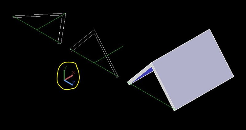

ReMark Posted December 11, 2014 Posted December 11, 2014 The best was to visualize what is happening to your UCS is to 1) Have the UCSICON turned on and 2) Utilize one of the four standard isometric views (I prefer the SE Isometric). When I start I am in the normal 2D view which is the default for any new drawing. Y is pointing towards the top of my screen, X points to the right and Z is coming straight out of the screen at me. I switch to my isometric view. I first rotate the UCS so X is pointing to the lower right hand corner of my screen and Z is pointing to the lower left hand corner of my screen. Kind of like this: Quote

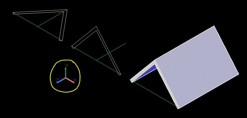

ReMark Posted December 11, 2014 Posted December 11, 2014 Next I rotate my UCS so it looks like this: I'm still old school and orient my UCS via the keyboard. I've done it so often this way I don't even have to look down at my keyboard to see what I am typing. There are versions of AutoCAD that have a feature called the Dynamic UCS where the UCS can be reoriented virtually on-the-fly. AutoCAD 2015 has this feature as well as a few previous releases. Can't recall when it was introduced but I could readily find out for you. Quote
