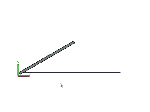

nestly Posted December 10, 2014 Posted December 10, 2014 In general, I agree with ReMark that it may be better to complete in 2D then EXTRUDE, but concerning your original question, simply SLICE using the same reference point(s) you used to MIRROR. Quote

nestly Posted December 10, 2014 Posted December 10, 2014 tzframpton said: Was SLICE available in AutoCAD 2004? Yes, but I should have tested prior to posting my previous instructions as SLICE works a bit different in 2004-2005 than shown in my previous post. Apparently, you can't specify the slice plane by merely clicking two points in an Orthogonal view, I had to specify the 3rd point as 0,0,1. Additionally, in 2005, I could not just hit a 2nd time to keep both sides... I had to enter "B" to make SLICE keep both sides. Been a long time since I did any 3D in that version... it doesn't even have transparent orbit (Shift+Middle button) Quote

idk14 Posted December 11, 2014 Author Posted December 11, 2014 nestly said: In general, I agree with ReMark that it may be better to complete in 2D then EXTRUDE, but concerning your original question, simply SLICE using the same reference point(s) you used to MIRROR. [ATTACH=CONFIG]51935[/ATTACH] So with your answer above mine two, this gif is not correctly because its done in a newer version right? Quote
Dadgad Posted December 11, 2014 Posted December 11, 2014 Welcome to CADTutor. Nestly explained in his last post which things you would need to do differently in 2004, than in his video, and how to do them using 2004. Quote
