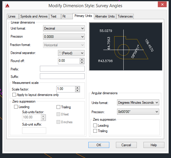

drafting1768 Posted December 9, 2014 Posted December 9, 2014 Hey! Just wondering if anyone can help me identify what I'm missing here. I've set my dimension style to the following (I've added images) and what I'm getting is 90d0"0" instead of 90d00"00" (which is what I want). Thanks in advance! Quote
SLW210 Posted December 9, 2014 Posted December 9, 2014 If it is 0 minutes and 0 seconds it will only show the single 0 for the minutes, Select a higher precision and it will show more 0's for the seconds. Quote

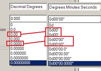

Dana W Posted December 9, 2014 Posted December 9, 2014 I'm also running 2015 and I don't see any way around suppressing the leading zero in the minutes & seconds. The weird part is that there are two identical choices for 0d00'00" in the precision drop down list, and both of them result in 90d0'0''. >>shrug Quote
drafting1768 Posted December 9, 2014 Author Posted December 9, 2014 I'm also running 2015 and I don't see any way around suppressing the leading zero in the minutes & seconds. The weird part is that there are two identical choices for 0d00'00" in the precision drop down list, and both of them result in 90d0'0''. >>shrug Yes, exactly! I noticed the two identical options too. This is massively inconvenient. What is the point in setting the precision to 90d00"00" if it won't show both zeros? Quote
Dana W Posted December 9, 2014 Posted December 9, 2014 Yes, exactly! I noticed the two identical options too. This is massively inconvenient. What is the point in setting the precision to 90d00"00" if it won't show both zeros?Yeah, and what's worse, they even offer the option of suppressing leading zeros. My Father-in-law was a Licensed Professional Land Surveyor who was persnickety about every bearing having exactly two digits in each position. There was a lisp program around for a while called label2 or something like that which would label the bearing (angle) with leading zeros along property lines, but it is not necessarily useful outside of civil drafting. Quote

nestly Posted December 10, 2014 Posted December 10, 2014 The duplicate entries exist in all versions AFAIK. It's because there's no way to round minutes or seconds to a single digit. Quote
